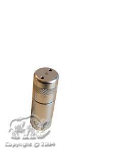

When I was an elementary student, we used 'Nitrous Oxide gas pellets' to launch homemade model rockets, suspended on a string, horizontally across the school lawn. And when I was a Boy Scout, we used them to launch toy model race cars down a curved ramp.
A 'cracker' is used to punch a hole in the nozzle.
Good memories, and a lot of fun!. . . I wonder what motivated me into physics anyway?
[/Color]
