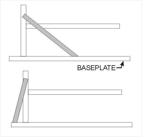

So I have a structure that I have to test, or more so a "model" structure.
It is in the shape of a T, but rotated on its side, so that the stem of the T is a cantilever beam. An actuator will be used to load the structure at the free tip of the stem.
My task is to design the supports of the structure such that it can be loaded in such a manner. I will be attaching bars/cables to the top to provide restraint, and will have a base plate at the bottom.
Herein lies the problem. The base plate rests on a concrete floor. I am not allowed to alter that concrete floor in any way, nor are there holes in the floor close enough to bolt the structure down.
So how do I prevent the base plate from slipping? Because if it slips, the results will be inaccurate and there is the risk of someone getting injured. There is also no way to fix the top of the column to something rigid.

Its 1m high and the cantilever is 1.5 m long. Its going to be loaded by a hydraulic actuator which is capable of producing a point load in its current configuration of 2500 kN, but I hardly doubt we will reach that. Its a vertical force going down.
What are the limits of the baseplate design? If the baseplate can extend all the way under the cantilevered beam, then it should be easy to counteract the actuator's force.
Also, if the column is supposed to remain static, I would add bracing, something like one of these:
Two side-view sketches of a test frame: a vertical column on a horizontal baseplate, with a horizontal beam and a diagonal brace, labeled BASEPLATE at lower right.
Note: The compression style bracing in top sketch is not attached to the beam -- it would be a pair of braces on either side of the structure.
  • Two side-view sketches of a test frame: a vertical column on a horizontal baseplate with a horizontal beam, one with a diagonal brace and one with a lean-back brace. The label BASEPLATE points to the bottom plate.

Also, thank you for the idea about the compression bracing, I totally forgot to even consider compression. Perhaps its because compression is that much more dangerous than tension - buckling AND yielding/fracture, as opposed to just yielding/fracture.
Ideally the entire system has to remain static, with only small deformations happening (less than say 20 mm at the maximum point).

Buckling doesn't necessarily lead to fracture. Quite often, partial buckling can serve as an indicator of failure, while still maintaining some support. Failure of a tension member tends to be sudden and complete.
Oh no no, don't get me confused. I know buckling doesn't always lead to fracture, its just compression members usually fail in one of two ways, whereas tension members I find only really fail in one.
But then again, my exposure to failure is extremely limited as I am still an undergrad. Just one more year to go.
MarleyDH said:
Compression members usually fail in one of two ways -- buckling AND yielding/fracture, as opposed to just yielding/fracture [in tension members].
Well said. And this is why the second diagram in post 4 is more efficient, stronger, and simpler, except that the column base plate does not need to be large, and the tension diagonal member preferably should be slanted at an angle of 45 or preferably 30 deg, measured from the ground, if you can afford the space. Tension members tend to fail gradually. Of course I am referring to your stated material. The tension diagonal will not slip if you use adequate bolt installation torque and enough bolts.
