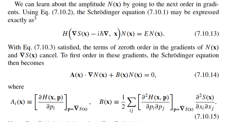

Hello everyone,
I don't get how the second-order derivative ##\partial^2 S/\partial x_i \partial x_j## of the phase S arrives here. If one performs a power series expansion of the Hamiltonian around ##\nabla S##, then I do get where the first term ##A## comes from, but then adding higher-order derivatives doesn't seem to introduce this second-order derivative of the phase S (even taking the somewhat
fuzzy footnote into account).
Does anyone who has read this book have an idea?
Thanks in advance.
Pierre
To put my question in perspective, I put below an excerpt of the corresponding page (I hope small quotes are ok on the forum; if not, please feel fee to let me know) in Weinberg's book.
Schrödinger's equation 7.10.1 is ##H(p,x)\psi(x) = E \psi(x)##. The idea is to assume a solution ##\psi(x)= N(x)e^{-iS(x)\hbar}## (Equation 7.10.2), in which case, after identifying as usual ##p## with ##-i\hbar\nabla##, Schrödinger's equation is equivalent to Equation 7.10.13 below. Then, my question amounts to understanding the right part of Equation 7.10.15, and thus 7.10.14.
Thanks.

My understanding of Equation 7.10.13 is that it is the transcription of Schrödinger’s equation when applied to ##\psi## defined in terms of ##N(x)## and ##S(x)##.
The application of the operator ##p = -i\hbar\nabla## to such ##\psi## yields ##-i\hbar\nabla N(x) e^{iS(x)/\hbar}+N(x) \nabla S(x) e^{iS(x)/\hbar}##, which is equivalent to ##((-i\hbar\nabla + \nabla S(x) )N(x)) e^{iS(x)/\hbar}##. So since the phase exponential part of ##\psi## is kept unchanged, it can be factored out of the whole Schrödinger’s equation on ##\psi##, giving 7.10.13, which only applies to the ##N(x)## part of the wave function.
Now, if one performs a first-order power series expansion of the Hamiltonian at ##\nabla S(x)##, one gets the first parts of Equations 7.10.14 and 7.10.15, but I don’t see how to obtain the second parts even with higher-order expansions.

Ok, going back to this after a small hiatus, I think I got it, and it's pretty simple in fact. Basically, from (7.10.13), one does a first-order expansion of H around ##\nabla S(x)##, yielding
$$H(\nabla S)N + (-i\hbar\sum_i\nabla_i)[(\partial H/\partial p_i)_{p=\nabla S} N] = E N.$$ The zero-th order terms ##H(\nabla S)N## and ##E N## cancel, as per (7.10.3). The remaining ##\nabla## yields then
$$ \sum_i(\partial H/\partial p_i)_{p=\nabla S} (\nabla_i N) + N\sum_{ij} (\partial p_j / \partial x_i)_{p=\nabla S} \partial/\partial p_j (\partial H/\partial p_i)_{p=\nabla S} = 0,$$
i.e., $$A.\nabla(N)+N {1\over 2}\sum_{ij} (\partial^2 S / \partial x_j\partial x_i) (\partial^2 H/\partial p_j\partial p_i)_{p=\nabla S} = A.\nabla(N)+NB = 0,$$
as in (7.10.14).
How to get 1/2 in your last equation ?
One needs the 1/2 prefactor since the term under the sum is symmetric in ##i## and ##j##, so one needs to counterbalance for the double counting. At least, this is how I make sense of it...
