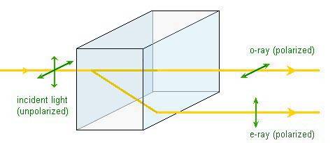

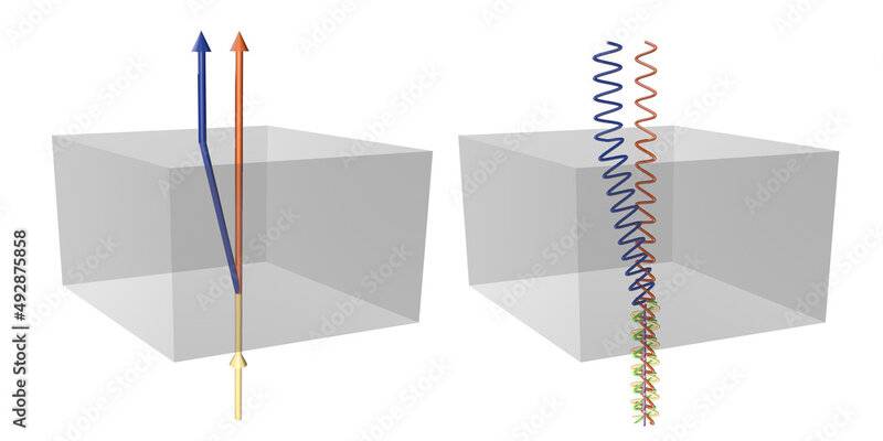

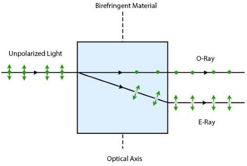

Hi.
Some results for "birefringence" in Google Image Search look odd to me:
Aren't they wrong? Why would there be refraction if the angle of indicence is 0°?
Science news on Phys.org
Tom.G said:
@greypilgrim The relevant section:
https://en.wikipedia.org/wiki/Birefringence#Double_refraction
wikipedia said:
So even in the case of normal incidence, where one would compute the angle of refraction as zero (according to Snell's law, regardless of the effective index of refraction), the energy of the extraordinary ray is propagated at an angle.
See also:
https://www.physicsbootcamp.org/section-birefrengence.html
physicsbootcamp said:
Clearly, one of these directions is consistent with Snell’s law of refraction, and the other is not.
