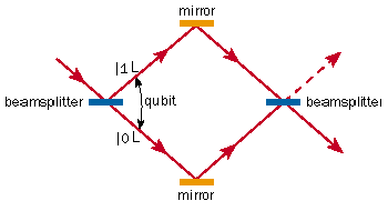

We all know how classical interference of waves can be produced by the Michaelson interferometer using the beam splitter and the detectors. No other elements needed to produce classical interference of waves.
Setups like this one which create quantum entanglement http://arxiv.org/abs/1212.6136 use beam splitter and detectors, but also use polarizers, wave plates, phase shifters and other elements together to entangle previously separable states.
Well, I am not an expert in quantum physics, only in classical physics, so I do not understand the difference between quantum entanglement and classical interference and what is the role that other elements play in the entanglement setup.
Could you explain to me what role do these other elements have? Why isn't the basic Michaelson interferometer used instead? What is the role of each element?

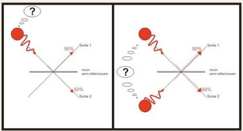

There is a difference between self-interference of photons that you call interference in your post, and two-photon interference that you ignore. The first creates superposition between the many trajectories of the same photon, while the second creates entanglement between two photons IF some additional conditions are fulfilled. What are these conditions?

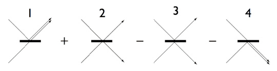

Two - photon interference (the four possibilities of two-photon reflection and transmission are added at the amplitude level):
Difference between self-interference and two-photon interference
Single-particle quantum interference
Interference fringes can be observed in a two-path interferometer if there is no way of knowing, not even in principle, which path the particle takes. In a MachZehnder interferometer a quantum particle strikes a beam splitter and has a 50/50 chance of being transmitted or reflected. Mirrors reflect both paths so that they meet at a second 50/50 beam splitter, and the numbers of particles transmitted/reflected by this beam splitter are counted. If no information about the path is available, the particle is in a superposition of the upper and lower paths. To observe interference one customarily varies the length of one of the paths (e.g. with a variable wave plate) and counts single clicks at the detectors as a function of this phase.
Two-particle quantum interference
When two particles are incident symmetrically on a 50/50 beam splitter it is possible for both to emerge in either the same beam (left) or in different beams (right). In general, bosons (e.g. photons) emerge in the same beam, while fermions (e.g. electrons) emerge in different beams. The situation is more complex for entangled states, however, and two photons in the Bell state |Y> emerge in different beams. Therefore, if detectors placed in the two outward directions register photons at the same time, the experimenter knows that they were in a |Y> state. Moreover, because we do not know the paths followed by the photons, they remained entangled.

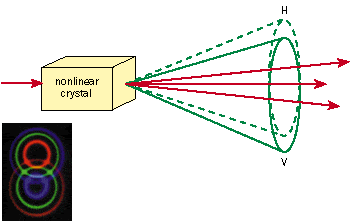

Decay into daughter particles
When an ultraviolet laser beam strikes a crystal of beta barium borate, a material with nonlinear optical properties, there is a small probability that one of the photons will spontaneously decay into a pair of photons with longer wavelengths (to conserve energy). The photons are emitted in two cones and propagate in directions symmetric to the direction of the original UV photon (to conserve momentum). In so-called type II parametric down-conversion, one of the photons is polarized horizontally and the other is polarized vertically. It is possible to arrange the experiment so that the cones overlap (see photograph). In this geometry the photons carry no individual polarizations all we know is that the polarizations are different. This is an entangled state. (P G Kwiat et al. 1995 Phys. Rev. Lett. 75 4337)

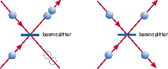

It is possible to use a beam-splitter to make two photons become entangled: https://physics.aps.org/articles/v7/25
My reading of that note is that each of those (bold) photons must belong to an entangled pair. This entanglement is transferred to one from each pair. I think the OP needs to be aware of that.

There is no one single formula which is used in all cases to create entanglement. For example, parametric down conversion creates entanglement in a fundamentally different manner than atomic cascades. And generally, you cannot entangle photons using a beam splitter alone.

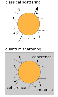

What do you think of this?
It reminds me DrChinese remark about pinholes.
Entangled photons on their own are not coherent because they are described by mixed states.
However, the entangled system of photons is coherent because it is found in a pure state.
In classical scattering of target body by environmental photons, the motion of the target body will not be changed by the scattered photons on the average. In quantum scattering, the interaction between the scattered photons and the superposed target body will cause them to be entangled, thereby delocalizing the phase coherence from the target body to the whole system, rendering the interference pattern unobservable.
Read more at https://en.wikipedia.org/wiki/Quantum_decoherence

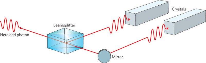

While the beam splitter needs additional elements to create entanglement between photons, it does not need these elements to create entanglement between atoms.
A single photon in superposition, when absorbed by two objects, creates entanglement between them.
There is no need for elements to prepare the photon for superposition, as superposition is an intrinsic property of the photon
A heralded single photon (the 'pea') first passes through a beamsplitter. The outputs of the beamsplitter are directed to the two crystals (the 'shells'), where the photon is absorbed to produce a single excitation. The lack of information regarding the path of the photon creates an entangled state between the two crystals.
