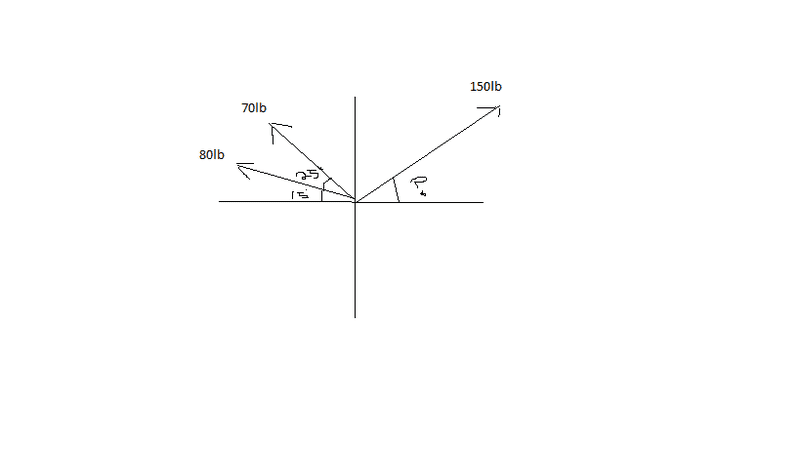

I have tried everything on this one that I can think of.
I understand that the forces in the horizontal are 0, but I don't know where to start.
says: determine the angle for which the resultant of the three forces is vertical. See Picture.
Please see this picture for above question.

What is the sum of the horizontal components of the two, fully defined forces?
The sum of the horizontal components, in the x direction, is:
70(cos140) + 80(cos165) = -131lb
to take it further;
70(sin140) + 80(sin165) = 66lb
r= (-131)2 + (66)2 = 147 lbs
inverse tan = 66/-131 = -27 degrees(I think I get it now) the resultant is vertical up.. so the sum of the left side is the same as right side...
to take it further;
Exactly, and with your creative use of 140o and 165o angles, you could simply have said
70(cos140o) + 80(cos165o) + 150(cosθ) = 0
Thanks lots Peter,
At first I was trying to rearrange " 70(cos140o) + 80(cos165o) + 150(cosθ) = 0" for the unknown angle and was frustrated as to why that wouldn't work.
tricky trick question.
Thanks, now I can sleep, lol.
