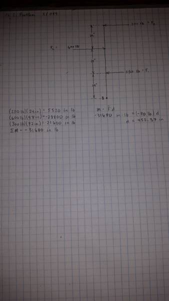

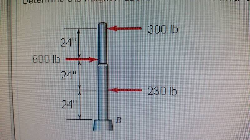

Determine the height h above the base B at which the resultant of the three forces acts.
M=Fd
not sure how to get the height here. thanks
im assuming the distance they are asking is less than 72 in. but I am not sure how to find that.
I guess i would need to put my forces in a formula where d is not the variable.[/B]
-31,680 in.lbs can't be right. Check your addition.
sweet thanks Nathanael!
