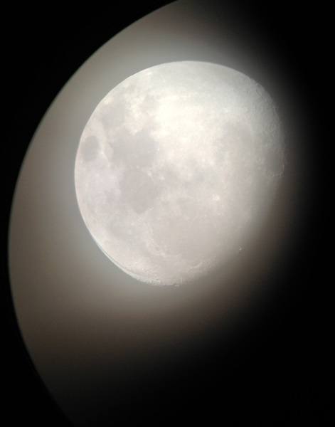

I put the scope together last night but by the time I got it ready, it got cloudy out.
Today, it was 100% visibility all day long but as soon as I got home, bam, clouds! Is this a curse or what?
I did manage to get a moon shot though since it was almost full.
Nice job QP!
I took the above by just carefully holding my iphone up to the eyepiece. I have a DSLR, is there a mount I can get which would allow me to mount it directly in front of the eyepiece?
Sweet, on sale too.
I would caution against eyepiece projection photography. It is more difficult than prime focus and generally yields disappointing results. Even planets typically yield better images at prime focus than with eyepiece projection. A good barlow lens is all you probably need.
