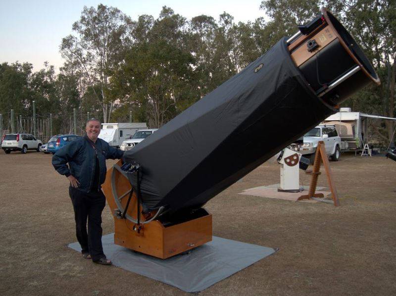

but if you are going to go big, one day make it worthwhile 30", f5 :wink:
from the recent Queensland Astrofest (Star party)
Terry Lovejoy ( of Comet Lovejoy fame -- earlier this year) took this pic of his friend Renato Langersek.and his scope
Missing the lift chair.
Likes davenn

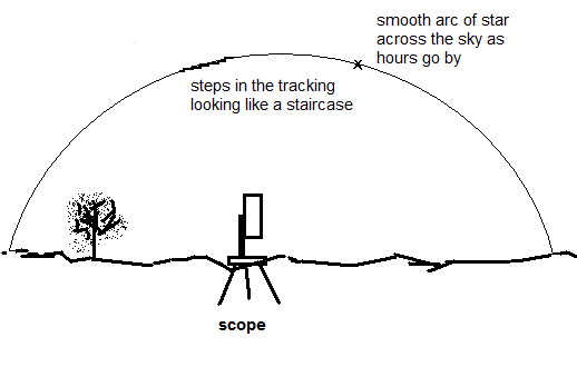

yes, this is correct, its the whole point of doing the alignment. BUT there is a huge caveat ( limitation)
There's something you may not have heard about called field rotation and this is not a problem for visual observing BUT is
a problem for doing long exposures, anything over around 30 secs
Field rotation is what happens to the object as seen through the scope, where the field of view rotates.
This happens because the scope isn't tracking the true motion of the star/object across the sky.
Stars and other deep space objects move in an arc across the sky rather than straight lines and
because of the Altitude / azimuth tracking of the scope it tracks the star/object in a series of small steps
rather than a smooth arc
will let you digest that whilst I draw a diagram to add to the text ...
Glenstr said:
Another thing I just thought of - unless I'm mistaken this telescope also tracks the stars, in that it will keep them in view & correct for the Earth's rotation. I'm thinking I should be able to fashion a mount somehow for a camera (where there's room), for example my Sony Nex 5 or A5100, and use it for longer exposures of the Milky Way etc.?
OK ...
star trail arcs ...
Al/Az tracking... rough drawing

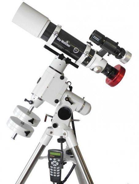

to track stars in a smooth arc, a different type of mount is used called an EQUATORIAL mount
This type of mount is aligned to the north or south celestial pole ( depending on if you live in the nthrn or sthrn hemisphere)
See that top pic and how everything is rotating around a central point ? that star near the centre ... yes, Polaris ... one of the scope's axis is aligned to the pole and the other axis will then track the true star motion across the sky
Dave

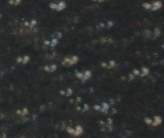

Folks here with a lot more experience than I have posted excellent replies regarding cameras/detectors, and I don't disagree with anything anyone has said. Even so, let me provide a different perspective.
First, it all depends on what you want to image- there is no such thing as a 'best camera' or 'best detector'. If you are imaging bright objects, such as the moon and planets, your optimal solution is likely a detector with very small pixels and a high frame rate- the sensors found in cell phones, for example. Then, you are able to acquire 200-300 images within a few seconds and stack them together, quickly producing an image with an extremely high signal-to-noise ratio and fairly high spatial resolution. Based on what I saw, any of the inexpensive sensors you linked to would likely be good solutions here.
For imaging faint objects tho, you'll need a sensor that has both larger pixels and lower noise than a cell phone. And while some people (aside from scientists) opt for specialized cooled sensors, it makes a lot of sense to use a digital camera. Adapting a digital camera to a telescope is pretty easy to do- there are inexpensive adapter plates to couple pretty much any digital camera to any telescope. Personally, I don't actually own a telescope- it's a telephoto lens. I use an adapter plate that couples my camera directly to a tracking mount, so I can use any of my lenses to image the night sky. I agree with davenn's comment regarding image rotation with an alt-az mount, but it's unclear (to me) what the performance limit (longest exposure time) is. Regardless, I have difficulty using my wide-angle lens even with an equatorial mount- the effect is hard to describe, but it's basically the same problem that cartographers have: mapping a curved surface to a flat surface. Here's a stack of 60 images, taken with a stationary tripod:
The distortion introduced by mapping the curved sky to a flat plane results in the non-uniform radial 'streaking'. Panoramic stitching is also difficult:
It may be hard to see because of the down-sizing, but there are regions that have multiple non-overlapping images of the same stars, seen here:
This is not due to the star streaks seen above, but the way neighboring images have different distortions; I'm still fine-tuning the alignment and hope to get a better final image at some point.

The result of all this is the reason why I recently lashed out and purchased a sturdy Equatorial mount
http://www.bintel.com.au/Mounts---Tripods/EQ-Mounts/Sky-Watcher-HEQ5-Pro-GoTo-Mount/96/productview.aspx
a HEQ5 PRO
minus the telescope ... I may yet add a scope to the mount
initially it will be used as a camera platform with either my 70 - 200mm or 100 - 400mm Canon lenses on the Canon 5D Mk3 DSLR camera
I also bought one of these auto guider units at the same time ...
a 50mm scope and ccd camera. you can see one attached to the top of the scope in the above pic
It will sit on a bracket beside the camera. Two cables from the auto guider
1) a USB lead that supplies power to the camera and an image to software for selecting a guide star
2) a cable between the auto guider and the main drive control of the mount where it passes tracking corrections to the mount drive
this will allow me to do multiple, say, 5 minute exposures which will hugely surpass the 30 sec exposure limitations I'm currently stuck with on the Al/Az mountcheers

3) actually, last night I noticed a problem that has been there all along, I've only recently gotten good enough to notice it- and I hope this isn't off-topic (if it is, maybe we can start a 'troubleshooting' thread...). Here's as many details as possible:
I typically setup as soon as it's dark enough, which is about 1 hour past sundown; after mount balancing and alignment I carefully focus the lens and lock it down. From there, I have about 1 hour of images that are *really* good- near diffraction limited. Then the images start to blur. Not motion blur and not focus drift- I'm not sure if it's thermal issues with the lens cooling down, or thermal problems with the atmosphere cooling down. Honestly, I'm not sure what the problem is.
Here's a crop from an 'early' image:
And a crop from an image acquired about 1 hour later- same lens and camera settings, and this is *after* I verified best focus:
Any advice is appreciated...

If you did refocus after that initial hour of imaging, I could only imagine that either
1) you dissed the focus point
2) atmospheric changes
3) The lens hadn't dewed over in the cool conditions ??
#3 caught me out one nite ... It shouldn't have I should have known better LOL ... took a little while
for the penny to drop and to figure out why images were blurry

Good ideas, but I ruled (1) and (3) out by inspection- I have a 10x loupe that I occasionally use to accurately focus, and I just looked through the lens for fog/condensation.
I'm now thinking that there were some high thin clouds that moved in- too thin to see by eye, but enough to cause scattering and blur the stars.
