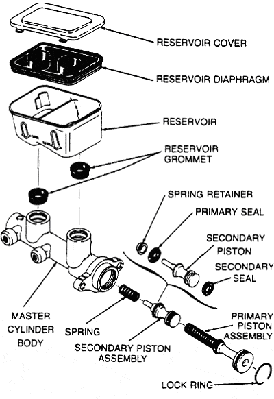

the 1/4 inch line costs more per foot but takes less labor time on assembly line. It has a longer life due to less vibration compared to smaller line. The smaller line requires many more clamps and time to attach the clamps. You do have different pressure coming from the master cylinder ,A disc/drum master cylinder has 1 large and 1 small reservoir and built in residual valve on the drum side. Disc/disc has the same size reservoir. Pretty sure the pressure is same in both but …rear disc normally has smaller pistons which require less pressure. I do know the disc/drum master cylinder has larger piston for the front and smaller piston for rear drum which would change the rear pressure. See attached pic.
I had a '76 Maverick front disc/rear drum with no power assist. Always stopped okay though i wondered how.
Different bores in the master cylinder , perhaps ?
