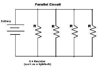

In regards to a node:
[tex]I_{IN}=I{out}[/tex]
Leads are referring to branches stemming from a node. Such is portrayed in the picture I provided, except there are 5 leads stemming from the top and bottom node.
  • Circuit schematic titled Parallel Circuit: a battery on the left feeds four resistors labelled R connected in parallel between a top and bottom wire, with the key R = Resistor (such as a lightbulb).

Would it be as simple as:
6 + 2x = 3 + 4.4 + 8.8
6 + 2x = 16.2
2x = 10.2
x = 5.1 A
