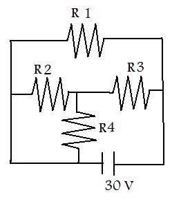

I need to find the equivalent resistance of the network outside the battery, and the current in resistor R2. the picture of my circuit is attached.
R1= 10 ohms
R2 = 6 ohms
R3 = 5 ohms
R4 = 30 ohms
series Req= R1+R2...
parallel 1/Req= 1/R1+1/R2...
I have a lot of trouble sseing this picture. i think is this:
R2-4 = 36 ohms
R1-3 = 1/(.3)= 3.333 ohms
Req= 36 + 3.33 = 39.333 ohms
is it right how i split them?
and would it the current trough resistor 2 just be:
V=IR 30/6 = 5 Ampere

So you have R2 + R4 + (R1 || R3) = 39.333 ?
(I can't see your picture as yet.)
What is the voltage across the whole thing?
when i broke it down in parallel and series, I'm not quite sure if i can assume that R1 and R3 are in parallel. Then i put togheter R4 and R2 as in series and plus R13 in series too..
but i don't know if i can do that.

Looking at your topography, consider redrawing and seeing if you don't find that you have :
((R2 || R4) + R3) || R1
Well, it's approved now.
Imagine an electron traveling from the right side of the battery to the left side. At first, it can either go through R1 or the branch containing R3 (not R3 itself), so R1 is in parallel with the branch containing R3.
What's the resistance of the branch containing R3? Remember that if the electron passes through this branch, it must pass R3, but after that, it has a choice between R2 and R4. In other words, R2 and R4 are in parallel; R3 is in series.
