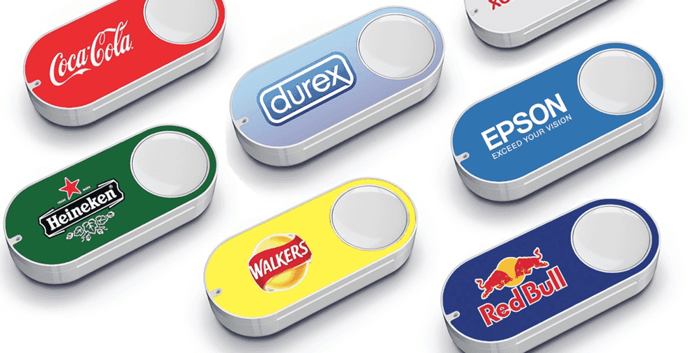

Think of this application. When the button is pushed, it transmits 1 bit (pushed) plus 1 unique ID. What protocol would you use for that? It is not a file, not a page, not an email. What would influence your choice of protocol?
Thanks!
Well, that is binary data being transmitted so a binary protocol. I see that there are many options in that department as well.
The main ideas is that different types of information require different protocols. Maybe there are cases in which the same type of information can be shared/sent using different protocols. I guess ftp is an example: we could view a wepage in browser communicating with the web server via http OR download the webpage from a ftp server using the ftp protocol...
It is not the data type that is relevant. It is the access pattern, timing and reliability requirements. Here, we have a one-way transmission of a small amount of data. We are not told about any timing, reliability or security requirements, though low latency seems like a likely goal.
Absent any other requirements, this practically begs for UDP: You wait for the button press, put the unique ID into a packet and send it. The receipt of the packet indicates that the button was pushed. The recipient takes the ID from the packet and is done. No TCP connection. No acknowledgments. No retransmissions. Dead simple.
