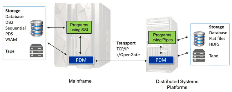

Alebra Technogies Parallel Data Mover (https://alebra.com/parallel-data-mover-pdm/) doesn't follow the OSI 7-layer model, but you could interpret some of it via that model . . .
