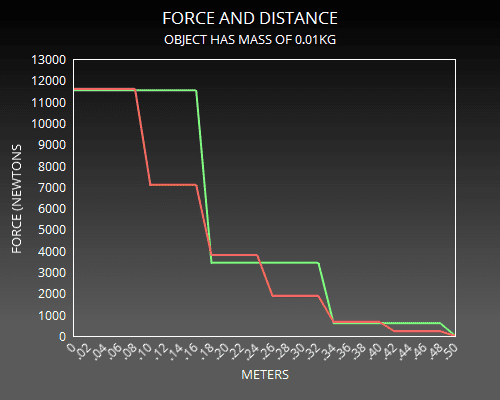

i have a set of different acceleration values that stop and start at set distances, and i need the final velocity. i made a graph that might be helpful... MIGHT BE...
Is the stair-step effect an artifact of a measurement process, or a feature of the actual system?
Assuming that the curves of F versus d are the actual force curves and that the force always acts along the line of motion of the object, then the change in potential energy between two locations is equal to the area under the curve between those two distances.
By the work-energy theorem the change in potential energy will be the negative of the change in kinetic energy. That is, ##ΔKE = -ΔPE##.
Magnets Yo said:
i have a set of different acceleration values that stop and start at set distances, and i need the final velocity. i made a graph that might be helpful... MIGHT BE...View attachment 94459
On an interval ##(t_0,t_1)## where the force ##F## is a constant, the differential equation for position ##x = x(t)## is
[tex]m \frac{d^2 x}{dt^2} = F \; \Longrightarrow \: x = a + b t + \frac{1}{2} \frac{F}{m} t^2,[/tex]
so if you know the initial position ##x_0 = x(t_0)## and initial velocity ##v_0 = v(t_0)##, you can solve for the "constants of integration" ##a,b## in terms of ##x_0, v_0, F##. Then you have a quadratic equation that can be solved to get ##t## in terms of ##x##. If you know that ##F## = constant on the interval ##x_0 \leq x \leq x_1##, you can find the time ##t_1## that gives you ##x(t_1) = x_1##. If you are given both ##x_0## and ##x_1##, your expression for ##t_1## will depend on the value of the initial velocity ##v_0##, so you need to know that before you can continue. You can then also calculate the final velocity ##v_1 = v(t_1)##, which you will need in the next part of the solution.
Now, if in the interval ##x_1 \leq x \leq x_2## the force has the form ##F = \alpha - \beta x##, (with constant ##\alpha>0## and ##\beta > 0##, as in your graph), the position ##x(t)## obeys the DE
[tex]m \frac{d^2 x}{dt^2} = \alpha - \beta x \: \Longrightarrow \: x = \frac{\alpha}{\beta} + A \cos(\omega t + \phi),[/tex]
where ##\omega = \sqrt{\beta/m}##. Here, ##A, \phi## are "constants of integration". If you know ##x(t_1) = x_1## and ##v(t_1) = v_1## from the previous interval, you can fit the values of ##A## and ##\phi## to that data. Then you can express ##t## in terms of ##x## as
[tex]t = \frac{\pi - \phi}{\omega} - \frac{1}{\omega} \arccos\left( \frac{\alpha - \beta x}{A \beta} \right)[/tex]
and so solve for ##t = t_2## that gives you ##x(t_2) = x_2##. You can also figure out the value of velocity ##v(t_2) = v_2##, which you will need for the next part of the trajectory.
For the next part of the trajectory you have constant force again, so repeat the first step, starting at ##t = t_2## with initial conditions ##x(t_2) = x_2## and ##v(t_2) = v_2##, etc., etc. Of course, the reason you want ##x## and ##v## to be continuous across the boundaries is that you cannot have a jump discontinuity in ##x(t)## and you do not have any infinite forces, so ##v(t)## cannot jump either.
You can keep going like that, switching between x-intervals of constant force to intervals of linear (in x ) force, fitting initial data in the next interval to final data in the previous interval. It is going to be messy and time-consuming, but essentially straightforward.
It is a feature of the actual system, yes.
The object in question receives "bursts" of acceleration across a given distance that weaken from one terminal to the next
