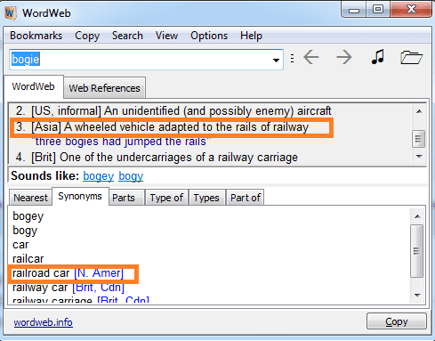

Yes, if the passenger (why do you call him "bogie"?) traveling up the incline with constant speed were to measure the acceleration of gravity, he would get 9.8 m/s2. The other passenger would measure something greater than that but not if he were on Mars and his acceleration were juuust right.
Because Lauren Bacall was in the other seat. Or maybe he was talking about the train wheels. I like the first one.
When I'm writing bogie, I'm referring to the train's car, in which the passenger is sitting.

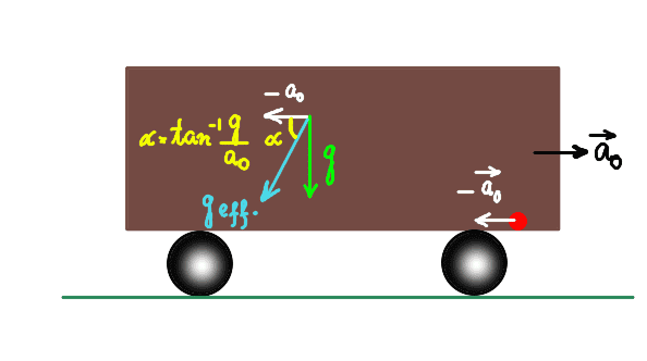

Sorry for coming into the discussion late, not least because the thread was mine. For some reason, PF alerts me only when a reply is sent to something that I have written - not to replies which people send to others in a thread that is (originally) my creation.
There are two observers in the problem. One is an observer in an accelerating train on horizontal ground with acceleration ##a_0##. The other is an observer in a uniformly moving train up an incline. If the first observer releases a marble towards the front of his carriage (compartment/boogie), he will observe the marble to accelerate relative to the carriage with an acceleration ##-a_0##. I don't see why you need to compute the effective gravity here, as the acceleration due to gravity ##g## will have no component parallel to the floor of the carriage.
It would be better to do as you have said. I draw a small diagram alongside. The value of ##g_{eff} = \sqrt{a_0^2+g^2}##. The component of this parallel to the floor of the carriage is ##\left(g_{\text{eff}}\right)_x = g_{\text{eff}} \cos \alpha = \sqrt{a_0^2+g^2} / \sec \alpha = \sqrt{a_0^2+g^2} / \sqrt{1+\tan^2 \alpha} = \frac{\sqrt{a_0^2+g^2}}{\sqrt{1+g^2/{a_0}^2}} = \mathbf {a_0}##, as claimed above.
