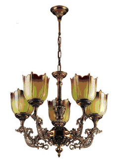

What are the forces acting on the chandelier?
cmkc109
103
See picture.
I want to know what are all the forces acting on this object.
If the object is 10N , the tension force suppose to be 10N. But wouldn' there be a normal force acting between the point touching the ceiling and the ceiling since ceiling is a surface?

Consider the equilibrium of the chandelier.
Now consider the equilibrium of the chandelier + Rope System.
Apply Newtons laws.
You will arrive at the answer.

quote "But wouldn' there be a normal force acting between the point touching the ceiling and the ceiling since ceiling is a surface? " end quote
There is force at the junction of suspender and ceiling. The force is normal to the ceiling. In relation to the suspender, the force is normal to the cross section of the suspender. Does that help?
Try standing up. There is a compression force between your feet and the ground. The force is normal to the plane of the floor and it is normal to the horizontal cross section of your body.

The best approach in dynamics to make a list of all the forces, their magnitudes, directions and their points of applications. The next step is to study the effects of these forces on the object on which they act. By equilibrium i mean that by 2nd law Fnet=0.
