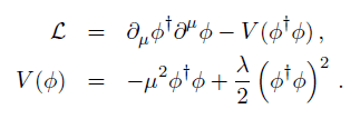

- What are the continuous global symmetries before and after the spontaneous symmetry breaking of doublet of scalar fields? And what is the proof for the symmetry?
The global symmetries of a Lagrangian remain unchanged before and after spontaneous symmetry breaking, specifically for a doublet of scalar fields. The Lagrangian is invariant under the global U(1) transformation, represented as \(\phi \to e^{i \theta} \phi\), and under the global SU(2) transformation, expressed as \(\phi \to e^{i \theta^{a} T_{a}}\phi\). Therefore, the global symmetry group of the Lagrangian \(\mathcal{L}\) is consistently SU(2) × U(1) throughout the process of symmetry breaking.
PREREQUISITESThis discussion is beneficial for theoretical physicists, graduate students in particle physics, and researchers focusing on quantum field theory and symmetry principles.
The global symmetries of a Lagrangian DON’T change “after the spontaneous symmetry breaking”. The Lagrangian you wrote is invariant under the global U(1) transformation \phi \to e^{i \theta} \phi. It is also invartiant under the global SU(2) transformation \phi \to e^{i \theta^{a} T_{a}}\phi. So, “before and after the spontaneous symmetry breaking” the global symmetry group of \mathcal{L} is always SU(2) \times U(1).wormwoodsilver101 said:Summary:: What are the continuous global symmetries before and after the spontaneous symmetry breaking of doublet of scalar fields? And what is the proof for the symmetry?
