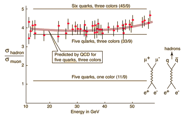

Indirect and direct evidence can be obtained from electron positron annihilation. The earliest evidence (IIRC) comes from the ratio of the total annihilation cross section in hadrons compared to muons, and I think this is what you refer to. The ratio displays constant values as a function of center of mass energy, jumping to higher values as more quark flavors are involved. For instance
See the full plots in figures 40.6 and 40.7

At this point, we may pause a little while. All of the above would still hold even if the SU(3) color would be approximate, in the sense that it would be slightly broken by a tiny gluon mass. "Tiny" must be compared to the typical hadronic scale, in between the pion and proton mass say. So 1 MeV is small and can easily hide. The data above is obtained at large energies. Electron positron annihilation does all sorts of nasty stuff around the GeV scale, due to contributions from various resonances of various width, as you can see in 40.6. People investigating the non-perturbative dynamics of cold hadrons do not have much luxury of using naked (perturbative) partons. We sort of circle back to the old constituent quarks, albeit with much more developed tools today. For instance Bethe-Salpeter and Dyson-Schwinger methods give results in agreement with lattice QCD (when they can be compared). So I meant to say, we are doomed if we look for better limits on the gluon mass : high energy data does not help, because perturbative gluons are so relativistic, for all purpose they would look massless anyway. And low energy data does not help either, because gluons dress and do acquire a (gauge covariant) mass which is also large compared to the MeV limit Yndurain already published in 1995. The reference comes from particle data group :
