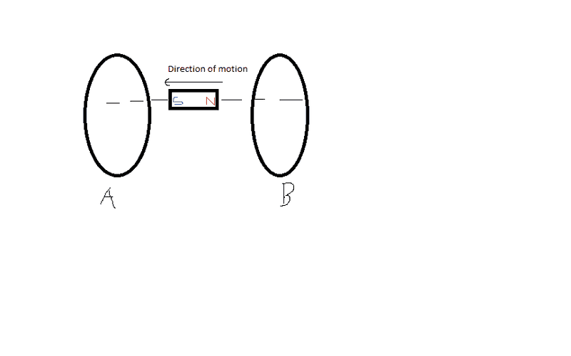

A bar magnet is moved between 2 coaxial coils A and B as shown in the figure.The end planes of the two coaxial coils facing the magnet due to induction will behave?
My solution:
It will induce south pole in A and B
south pole in A as the coil needs to oppose the magnet
south pole in B because the coil needs to attract the magnhet
(I have read these properties in a book,so I am just applying them but I don't know what's the logic behind them)
pratyushag said:
magnetic flux have definite direction and they never cross path, always from North to South forming a complete closed loop. think about it.
