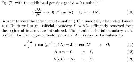

Ren_Hoek
Typeset equations (10) to (13) of an eddy current problem: sigma times the time derivative of A plus curl(mu^-1 curl A) equals Je plus curl M, with boundary and initial conditions for A.

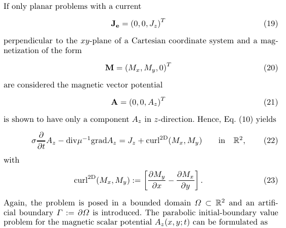

Typeset page of equations from a paper on planar magnetostatic problems, showing current density J_e = (0, 0, J_z), magnetization M = (M_x, M_y, 0), vector potential A = (0, 0, A_z), the PDE sigma dA_z/dt - div mu^-1 grad A_z = J_z + curl^2D(M_x, M_y) in R^2, and the definition of curl^2D.
In (23), are grad and div some kind of scalar operators comparing to ##\nabla## and ##\nabla\times##?
because tbh I dont know how ##\text{curl}(\mu^{-1}\text{curl}\textbf{A})## turns into ##\text{div}\mu^{-1}\text{grad}A_z## even given ##A=(0,0,A_z)^T##.

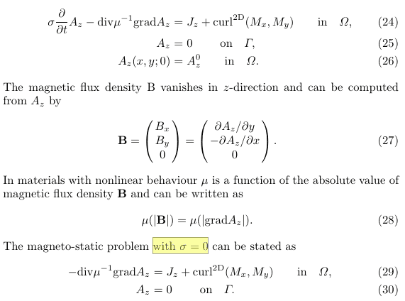

Equations (24) to (30) for a 2D magnetostatic/eddy-current problem: sigma times partial A_z over partial t, minus div mu inverse grad A_z, equals J_z plus curl 2D of (M_x, M_y); boundary and initial conditions A_z = 0 and A_z(x,y;0) = A_z^0; B = (dA_z/dy, -dA_z/dx, 0); mu(|B|) = mu(|grad A_z|); and the magnetostatic case with sigma = 0 highlighted.
tbh I don't really get it. First, Is \sigma, which I assume is electrical conductivity, related to static magnetic field?

thank you.
No matter how I calculate (calculating directly or using ##\nabla\times (\nabla\times A)=\nabla(\nabla\cdot A)-\nabla^2 A##), it is
$$\text{curl}(\text{curl} A) = (\dfrac{\partial^2 A_z}{\partial x\partial z}, \dfrac{\partial^2 A_z}{\partial y\partial z}, -\dfrac{\partial^2 A_z}{\partial x^2}-\dfrac{\partial^2 A_z}{\partial y^2})^T$$
for me so I don't know what this section of the book is talking about.
I think grad before ##A_z## seems redundant here, as ##\text{curl}(\text{curl} A)_z=-(\dfrac{\partial^2 A_z}{\partial x^2}+\dfrac{\partial^2 A_z}{\partial y^2})## here, so as long as ##\dfrac{\partial^2 A_z}{\partial z^2}=0## it is much more understandable, but I couldn’t find evidence of it and maybe it's related to strong physics meaning which I'm not good at.

Don't forget that by eq.(28) in your posted text, the permeability can also be a function of the transverse-position (as well as time): ##\mu=\mu(x,y,t)##. Just use the basic definition of the curl in cartesian coordinates and "turn the crank" twice to get the result in eq.(22) of your text:$$\mathbf{A}=\left(0,0,A_{z}(x,y,t)\right)^{T}\Rightarrow\nabla\times\mathbf{A}=\left(\partial_{y}A_{z},-\partial_{x}A_{z},0\right)^{T}\Rightarrow\mu^{-1}(x,y,t)\nabla\times\mathbf{A}=\left(\mu^{-1}\partial_{y}A_{z},-\mu^{-1}\partial_{x}A_{z},0\right)^{T}$$$$\Rightarrow\nabla\times\left(\mu^{-1}\nabla\times\mathbf{A}\right)=\left(0,0,-\partial_{x}\left(\mu^{-1}\partial_{x}A_{z}\right)-\partial_{y}\left(\mu^{-1}\partial_{y}A_{z}\right)\right)^{T}=-\nabla\cdot\left[\mu^{-1}(x,y,t)\nabla\left(0,0,A_{z}(x,y,t)\right)^{T}\right]$$No "strong physics" involved!
Thank you, I see.
But how does ##(A_x, A_y) = (\mu^{-1} \dfrac{\partial^2 A_z}{\partial x\partial z}, \mu^{-1} \dfrac{\partial^2 A_z}{\partial y\partial z})## turn into (0, 0) or are they simply neglected since we're considering the z axis? or was my calculation wrong?
I think ##\dfrac{\partial A_z}{\partial z} = 0## as suggested in (28), it is also suggested in the expression ##A_z(x,y;t)## as it does not contain ##z##, and will make the second order derivative to 0 in the above case.

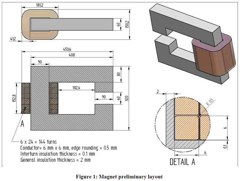

OK, that clarifies your configuration. From Google, there are a fair number of references about modeling C-electromagnets. For example, CERN Dirac C-magnet:
Preliminary layout of a C-shaped magnet with a coil: top views of the coil and yoke with dimensions, a front section with dimensions and a note of 144 turns of 6 mm conductor, an isometric view of the yoke and coil, and a Detail A close-up of the conductor insulation.

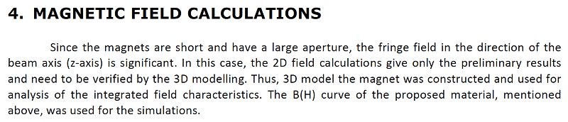

Since the transverse size (##x,y## directions) is large compared to the ##z##-extent, your 2D FEM model is only an approximate representation of the actual magnet. As the reference says:
Printed text under the heading '4. MAGNETIC FIELD CALCULATIONS' stating that 2D field calculations give only preliminary results and 3D modelling was used to analyse the integrated field of the magnet.

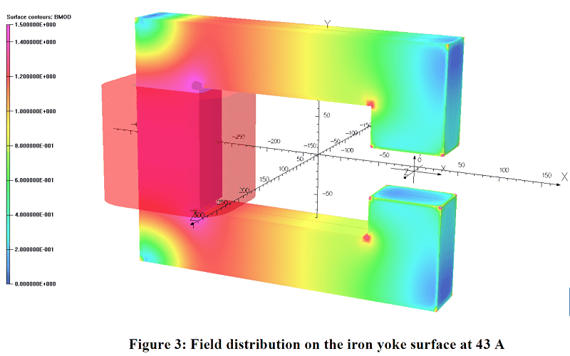

Here's the full 3D model of the magnetic field:
3D finite element plot of a C-shaped iron yoke with surface contours of BMOD, colour scale 0 to 1.5, caption: Field distribution on the iron yoke surface at 43 A.
Of course, in the analysis and model you've cited, you apparently have the additional complication of time-dependent currents and fields. So it's a fairly complex problem.
