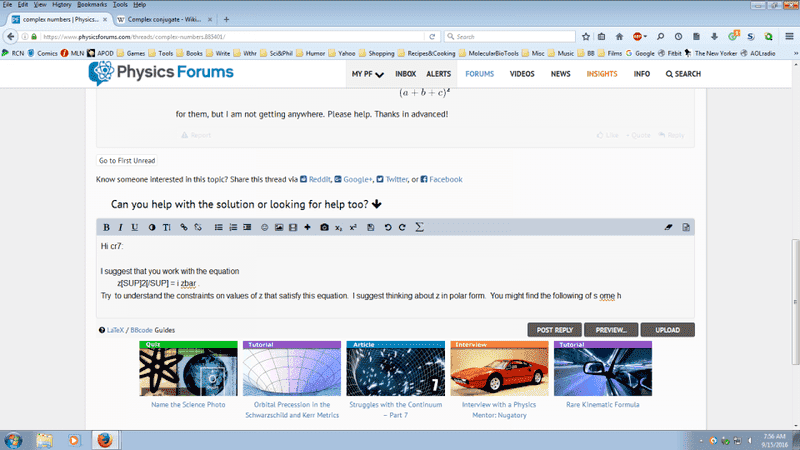

PS. I have no idea why that PNG file got attached. Please ignore it.
