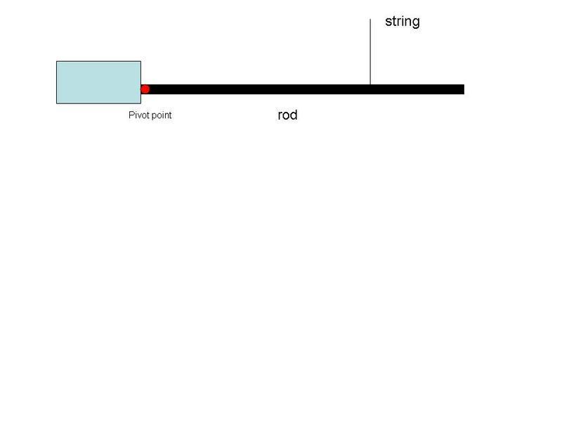

A thin rod of length l and mass m is fixed at a far ends by a free pivot and held from rotating with a string attached at 3/4l and fixed toa ceiling. The moment of inertia of a thin rod about a far end is ml2/3
a) what is the pivot point exerting on the rod
The rope is cut at t =0 seconds. at t =0 seconds find:
b) the angular acceleration of the rod.
c) the transverse acceleration of the rod's center of mass.
d) the transverse aceleration of point A (the far end of the rod)
e) the force exerted by the pivot point
picture is attached.
You have to at least try the problem and explain your thoughts before asking for help.
First, total downward torque = upward torque.
.5mgl + Torque of pivot point = .75mgl
torque of pivot point = .25mgl.
This doesn't make sense because the pivot point can't exert a torque.
Thats all I got to...and I couldn't figure out anthing else lol
I have all the answers, I just need to understand hwo to do it.
