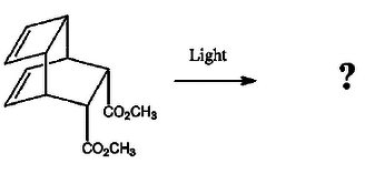

First one:
is this an intramolecular [2+2] photocycloaddition?
And this one:
I'm fairly confused about this one. Could it be an intramolecular Alder-ene reaction? Whats confusing me most is that cyclopropyl ring up there. I know they're pretty unstable and I read that they open during electrocyclisations and stuff like that so I'm wondering if it plays a role in this reaction.

It's been a while since I studied chemistry, but since no one answered, I'll throw my 2 cents.
For #2:
It's a fairly safe bet that the cyclopropane ring will open, leaving a temporary + on the quaternary carbon. There are two things that make this easier: the carbonyl oxygen can donate electrons through the conjugated double bonds, and the + is stabilized by the methyl group.
Then, I think, the 6-membered ring will close with rearrangement of protons.
