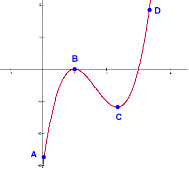

https://www.physicsforums.com/attachment.php?attachmentid=47375&stc=1&d=1337282982
Given the following graph of the function y = ƒ(x) Find the interval(s) x value(s) for which each of the following is/are true ( Enter your answers separated by commas with no spaces. eg. A
ƒ′(x) = 0
= B, C
ƒ′(x) > 0
= D
ƒ′(x) < 0
= A

  • Graph of a cubic function y = f(x) with labeled points A, B, C and D; the curve rises through A, peaks at local maximum B near x = 1, dips to local minimum C near x = 2.3, then rises steeply through D.
Graph question: two wrong.
