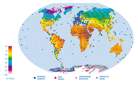

However have a look at the isotope in precipitation chart of [url=http://www-naweb.iaea.org/napc/ih/IHS_resources_gnip.html]GNIP[/url]:
[ATTACH=full]154744[/ATTACH]
Although there is a clear temperature dependence for isotope in precipitation, there are also abberations. You can't see the cold winters in Argentine or the hot summers in China, based on the isotopes.

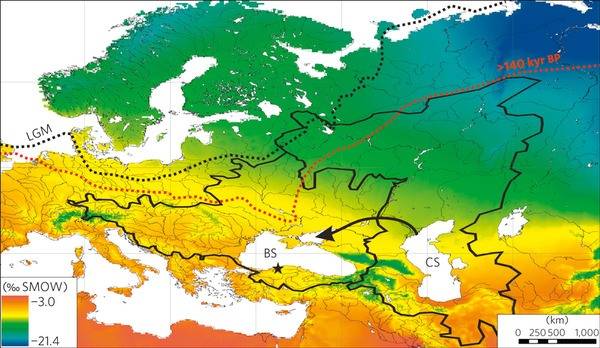

[URL]http://www.nature.com/ngeo/journal/v4/n4/full/ngeo1106.html[/URL]:
[ATTACH=full]154745[/ATTACH]
These isotopes would suggest that the temps of Greece and Belgium are about equal. The locals will tell you that this is not really the case, also when yellow here is the same yellow in the upper chart, then Shri Lanka would be as cold as The Netherlands. That would be hard to sell too.
