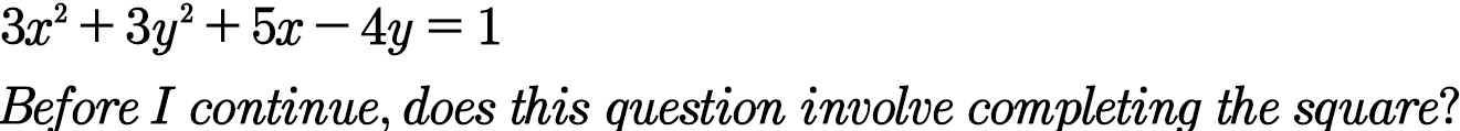

Determine the center and radius of circle.

Why not continue and find out?
Doing so will give you experience, and experience will allow you to answer these sorts of question for yourself in future situations.
3x^2 + 3y^2 + 5x - 4y = 1
3x^2 + 5x + 3y^2 - 4y = 1
x^2 + (5/3)x + y^2 -(4/3)y = 1/4
Half of (5/3) is (5/6). Then (5/6)^2 = (25/36).
Half of -(4/3) is -(2/3). Then (-2/3)^2 = (4/9).
We add (25/36) and (4/9) on both sides of the equation.
x^2 + (5/3)x + (25/36) + y^2 -(4/3)y + (4/9) = (1/4) + (25/36) + (4/9)
Factor left side and calculate the right side.
(x + 5/6)(x + 5/6) + (y - 2/3)(y - 2/3) = (25/18)
(x + 5/6)^2 + (y - 2/3)^2 = (25/18)
The center is (h, k) = (-5/6, 2/3).
Let r = radius
r^2 = (25/18)
sqrt{r^2} = sqrt{25/18}
r = [5•sqrt{2}]/6
Is this correct?
= 1/3, not 1/4.
Again, the right side should be 1/3+ 25/36+ 4/9. 1/3, not 1/4.
1/3+ 25/36+ 4/9= 12/36+ 25/36+ 16/36= 53/36
Let r = radius
r^2 = (25/18)
r = [5•sqrt{2}]/6
Is this correct?
Not the radius. The radius is sqrt(53}/6.
On the right side, I should have 1/3, as you said, not 1/4. Simple computation error that led to the wrong answer. Overall, I understand the procedure which is more important.
