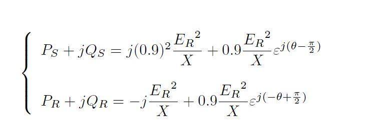

Hi,
how do I find the center and radius from these equations? The 2 equations represent 2 different circles, by the way. I need to draw 2 circles.

The equations are actually equations of power transmission and power reception circle diagram.
I am sorry for not having an attempt but I am stuck here.
I presume that the "[itex]P_S+ jQ_S[/itex]" and "[itex]P_R+ jQ_R[/itex]" on the left of those two equations are the complex variable "z" that is to be graphed.
An equation of the form "[itex]z= Ae^{j\theta}[/itex]", with A a real number and [itex]\theta[/itex] from 0 to [itex]2\pi[/itex], is a circle with center at 0 and radius A. An equation of the form "itex]z= B+ A{j\theta}" is a circle with center at the complex number B and radius A.
Of course, as [itex]\theta[/itex] goes from 0 to [itex]2\pi[/itex], [itex]\theta- \pi/2[/itex] goes from [itex]-\pi/2[/itex] to [itex]3\pi/2[/itex] but the graph still covers the circle, just "starting" at a different point. The first circle has center at the point [itex]j(0.81)E_R^2/X[/itex] in the complex plane, which is [itex](0, 0.81E_R^2/X)[/itex], and radius [itex]0.9E_R^2/X[/itex]. The second has center at [itex](0, -0.81E_R^2/X)[/itex] and the same radius.

How do you get [itex](0, -0.81E_R^2/X)[/itex] for the second circle? Shouldn't it be ##(0,-E_R^2/X)##? I forgot to mention that ##P_S##+##jQ_S## are indeed a complex number in the form Z= X+iY because P is the real power while Q is the reactive power.
