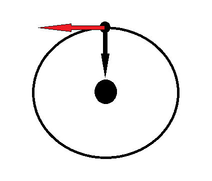

I watched a lot of videos and read a lot of articles regarding the orbit of the Earth around the sun and I just did not get it ..if they're both attracted to each other by a force then why don't the Earth just hit the sun like two magnets attracted to each other ..what causes that "Orthogonal" force to make the Earth orbit around instead of just collide with the sun?
There is no orthogonal force. All of the force is radial. And that's important.
It's easiest to understand when you consider a nice circular orbit. In that case, the motion of the planet is at constant radius. The force is always 90 degrees to the motion. So what happens to the angular momentum of the planet? What is the total work done by gravity?
It's just a tiny bit harder to see when you think about non-circular orbits. But if you go look up "directrix" in your geometry text, you can fairly directly get the orbit in Newtonian gravity field. Armed with that, you can work out what happens to the angular momentum over an orbit.
ok it's a perfect circular motion.
what causes the force represented in by the red arrow
In uniform circular motion the force represented by the red arrow is zero.
I think the point you're missing is Newton's First Law. "Every object in a state of uniform motion tends to remain in that state of motion unless an external force is applied to it."
There is no force like the red arrow. As the previous poster told you, either the body in orbit was captured or it formed from a spinning disk. In either case, the motion existed before the body went into orbit, and no force is necessary to keep it in motion.
That's not a force. It's momentum.
Suppose you take a quick drive to the grocery store. You put the groceries you bought on the passenger's seat and head for home. On the way home, some fool cuts in front of you, slams on their brakes, and makes a sharp turn. You in turn have to slam on your brakes, hard.
What happens to you and those groceries?
The answer is that you pitch forward, and hopefully you are wearing your seatbelt. Presumably you didn't put a seatbelt around those groceries. They fly off the seat, hit the glove compartment, and land on the floor. No force made you pitch forward or made the groceries fly off the seat. That was just Newton's first law in action. A force is applied a moment later when your seatbelt locked, and when the groceries hit the glove compartment.
Introductory level students don't appear have a conceptual problem with Newton's laws when applied to straight-line motion. Misconceptions arise when the motion is not along a straight line. This is where I think Basimalasi is getting confused.
Basimalasi, that red line isn't a force. It's momentum, the exact same thing that made the groceries in my example fly off the seat. Momentum is a vector. Any change to that vector requires an external force. That can be a change in speed, in direction, or both.
In the case of uniform circular motion, the force is necessarily perpendicular to the momentum vector. In other words, it points toward the center of the circle. Always. That this is a perpetual source of confusion is why introductory physics educators spend so much time on uniform circular motion problems.
