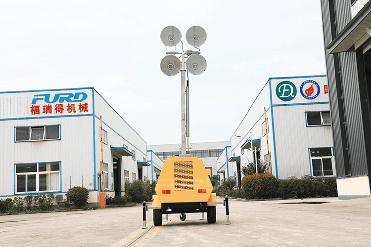

Could it have been a generator? Maybe one of those road-side construction types?
A crew rolls up to fix some part of the highway, erects a set of lights powered by a diesel generator, gone in a few minutes.

This wouldn't be scheduled work; it would be a reported incident.
Some hazard on the road is reported by a motorist - downed branch, flotsam or roadkill. A highway crew shows up, fires up their diesel-powered god lamps, clears the obstruction off the road in ten minutes, and then spends two hours filling out reports.
