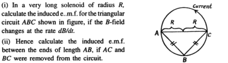

Text problem parts (i) and (ii) on solenoid induced e.m.f. beside a circle of radius R containing triangle ABC, with segments AC and BC marked, arrow labelled Current on the circle, and R marked on each half of AC.
First part is easy . Area of the triangular loop is A = (1/2)(2R)(R) = R2
Induced EMF in loop ABC = Rate of change of flux = dΦ/dt = AdB/dt
= R2(dB/dt) which is correct .
Now the second part has stumped me .
I would really appreciate if somebody could help me with this .

  • Text problem on the left about a long solenoid of radius R with a triangular circuit ABC; right, a circle with current arrow, chord AC marked R and R from the centre, and point B below with tick-marked sides AB and BC.
My interpretation of part (ii) is that it is asking for the magnitude of the line integral ##\int \mathbf E \cdot \mathbf {dl}## along the straight line AB.
If so, then use the result from (i) along with symmetry arguments.

Thanks for replying .
The induced electric field lines will be concentric circles . So I can't see how line integral can be calculated .
How would we use symmetry in this ?
What's the value of the line integral for the entire triangular circuit?
What's the value of the line integral for the horizontal segment AC?
You made it look so easy :) . I have been thinking about it for last couple of days .
R2(dB/dt)
As we move along from C to A along CA , direction of induced electric field would be perpendicular at every point of the path CA as CA is a a diameter and induced electric field lines would be concentric circles .The line integral would be zero along CA .
Since field lines are circles , the paths AB and AC would look similar and their line integral would be equal .
##\int \mathbf E \cdot \mathbf {dl}## along the closed loop ABC =
##\int \mathbf E \cdot \mathbf {dl}## along the straight line CA + ##\int \mathbf E \cdot \mathbf {dl}## along the straight line AB +##\int \mathbf E \cdot \mathbf {dl}## along the straight line BC .
##\int \mathbf E \cdot \mathbf {dl}## along the straight line AB =
R2(dB/2dt) .
Is that alright ?
Yes, that looks right to me.

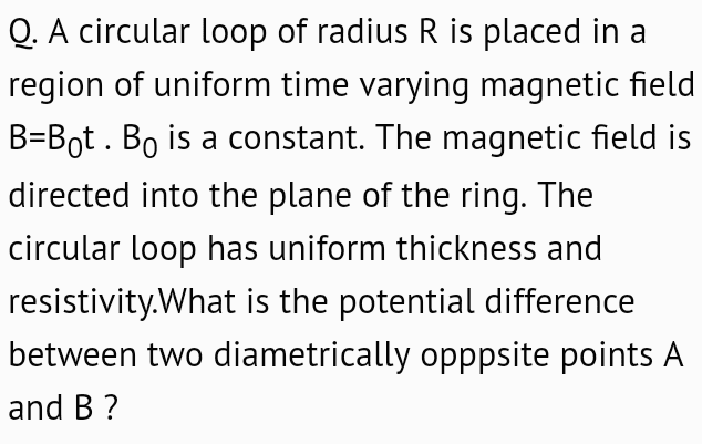

I came across a much simpler question than this which has left me a bit puzzled .
Text problem: circular loop of radius R in uniform time-varying magnetic field B = B0t, directed into the plane; asks potential difference between diametrically opposite points A and B.
Induced EMF ε across circular loop = Rate of change of flux = πR2B0
Current i flowing in the loop = ε/r . r is the resistance of the loop .
Resistance of semicircular wire AB = r/2 .
∫Edl between A and B along the circumference = ε/2
Now how do I calculate potential difference between A and B ?
Is Potential difference between A and B = (Induced EMF between A and B) - (iRAB) ?
The two terms are equal resulting in 0 potential difference .
I am quite perplexed by this result .
It is zero. There is no electrostatic voltage present because of the uniform resistance of the ring. The electrostatic potential difference appears because of non-uniform resistance and the fact that KCL has to be satisfied at every point. Here, the resistance is uniform, so there is no electrostatic voltage.

@Amplitude. cnh1995 posted a reply while I was constructing a reply. I’ll go ahead and post my thoughts with the warning that the way I define “emf for a path” in the remarks below is not the same as cnh1995’s “electrostatic voltage” that he refers to.
Let me start with some basic remarks just to clear the way for addressing your question. I apologize if you’re already familiar with this.
When you have a changing B field, it doesn’t really make sense to ask for the potential difference between the points A and B.
In electrostatics with no changing B field, you have a potential function V such that the work needed to move a unit charge from A to B is independent of path and equal to VB – VA. The concept of potential difference between A and B is meaningful.
In the situation you have posed, the work needed to move a unit charge from A to B cannot be written as the difference in value of a potential function V. Such a function does not exist in this case because the work needed depends on the path from A to B. (I guess you could try to separate out the part of the E field that is due to static charge and define a potential function associated with that field, but I don't see any use in doing that.)
Now, even when there is a changing B field, there is a value of the net E field at each point of space. So, for a particular path from A to B, there is a well-defined value of the line integral of Enet. I don’t see anything wrong with calling the negative of this integral “the emf for this path”. The emf will be path dependent. I guess you could call this emf, “the potential difference for the path”. But that’s kind of misleading since it does not represent the difference in a potential function.
OK, with that out of the way, how do we interpret the problem you have stated in post #25 where it asks for the “potential difference between two diametrically opposite points A and B”? Once you pick a path between A and B, you can ask for the emf of this path (defined as the negative of the line integral of Enet along the path). But the answer will depend on the path. If you take the path to be the diameter of the circle from A to B, then you will get zero for the emf of this path.

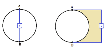

What will a voltmeter read when put across A and B ?

Suppose half of the ring has a resistance R and othe other half has a resistance 2R.
"Induced" elevtric field in the ring will be same at every point, regardless of the resistance. So, for both the halves, the emf induced will be E/2.
Now, compute the currents through both the halves assuming just the "induced" field as the driving quantity. The currents are not same in both the halves. To make the currents same in both the halves, there is an electrostatic voltage developed in the circuits such that it increases the net electric field in the part of high resistance (2R) and decreases the net electric field in the part of lower resistance (R), so that the currents through both the parts become equal.
