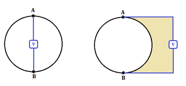

Amplitude said:
What will a voltmeter read when put across A and B ?
The reading of the voltmeter will depend on how the meter is placed between A and B. If it is placed in the center of the loop with the leads of the meter going straight to points A and B, the meter will read zero. See left figure below.
If the meter is placed as shown on the right, the voltmeter will not read zero. The reading will depend on the shaded area (assuming the region of magnetic field encompasses this area).
Two circle diagrams with points A at top and B at bottom, each with a voltmeter labelled V. Left: straight leads run from A to B through the centre, meter inside the loop. Right: leads form a shaded region bounded by the circle and a rectangle on the right.
Zero, assuming the leads are not inside the magnetic field.
Edit: Posted a moment after TSny..
Does a voltmeter read ∫Edl along the path from A to B through it ?
If so , how does it read the line integral ?
In a DC circuit a voltmeter measures the potential difference between two points which in turn is directly proportional to the current flowing through the voltmeter ( a Galvanometer converted into a voltmeter ) .
It doesn't. It reads the eletrostatic potential difference which is caused by surface charges. In circuits with no varying B-field, this potential difference is equal to the line integral of E.dl along that path (or along any path joining the two points, since the field is conservative).
In this circuit, there is a non-conservative field present and hence, the line integral of E.dl is not same as the electrostatic potential difference here.
If the voltmeter doesn't read the ∫Edl then how does it read 0 in the left figure ?
Isn't ∫Edl = 0 along the diameter ?
Amplitude said:
Does a voltmeter read ∫Edl along the path from A to B through it?
Yes, I believe so.
In both cases a very small current flows through the meter which is proportional to the line integral of Enet through the meter.
It is zero because E=0 "along" the diameter.
This is assuming the voltmeter loop is not inside the magnetic field. If it is in the magnetic field, the current (or net E-field) through the voltmeter will be due to the sum of electrostatic and induced fields, hence, it will read the integral E.dl. through the meter.
