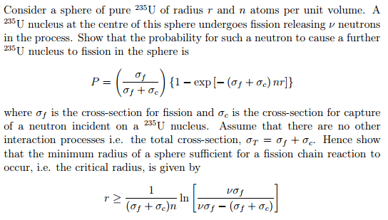

See the image below:
In the previous part, it was proved that a particle moves through a distance x in a material without interacting with probability P given by
[itex]P=\exp(-\sigma n x)[/itex]
Here σ represents the cross section of the reaction between the incoming particle and the material. n represents the target (material) particles per unit volume.
The only thing I have figured out so far is that we need the probability of the neutron not escaping without a reaction, so there is a factor of
[itex]1- exp(- (\sigma_f + \sigma_c) nr )[/itex]
in the equation.
I am not sure of where the fractional factor at the start of the equation comes from, or why the total cross section appears in the exponent.
Bump! Does no one have any ideas, I haven't been able to solve this since the last post.
The sum in the exponent is simple: it is because cross-sections of different reactions are additive.
Thus (1 - exp) is the probability that the neutron will be captured or cause fission. You need to express from this the probability of fission.
