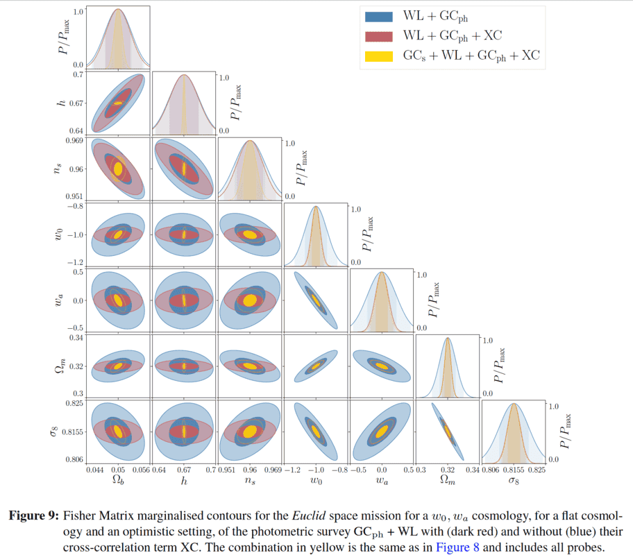

I would like to understand better the plotting of contours and the signification of the diagonal, .ie knowing if it corresponds to posterior distribution or not.
I am curently working on Forecast in cosmology and I didn't grasp very well different details.
Forecast allows, wiht Fisher's formalism, to compute constraints on cosmological parameters.
I have 2 issues of understanding :
1) Here below a table containing all errors estimated on these parameters, for different cases :
245904
In the caption of Table 16, I don't understand what the term "Marginalized 1##\sigma## erros" means. Why do they say "Marginalized", it could be simply formulated as "the constraints got with a ##1\sigma## confidence level" or ""errors with a ##1\sigma## C.L (68% of probability to be in the interval of values)", couldn't it ?If it would have been written "marginalized ##2\sigma## error, the first value in Table 16 would have been equal to ##(\Omega_{m,0})_{2\sigma}=0.032 = (\Omega_{m,0})_{1\sigma} =0.016 \text{x} 2##, wouldn't it be the case ?I would like to understand this vocabulary which is very specific of this Forecast field.2.1) Here below a figure representing the correlations (by drawing contours at ##1\sigma## and ##2\sigma## C.L (confidence levels)) between the different cosmological parameters :
245905
I have understood, the right diagonal (with Gaussian shapes) represent the posterior distribution, i.e ##\text{Probability(parameters|data)}## or the probability to get an interval of values for each parameter, knowing the data.But how to justify that I have these posterior distribution on this descending diagonal ?I know the relation : ##\text{posterior}= \dfrac{\text{likelihood}\,\times\,\text{prior}}{\text{evidence}}## or the equivalent :##p(\theta|d)={\dfrac{p(d|\theta)p(\theta)}{p(d)}}## with ##\theta## the parameters and ##d##the data.We can use Fisher's formalism assuming likelihood is Gaussian, and the posterior are obtained by inverting the Fisher's matrix.So I wonder what are the others cases (except this diagonal) plotted and mosty what they represent in the formula above, especially towards posterior distribution :##\text{posterior}= \dfrac{\text{likelihood}\,\times\,\text{prior}}{\text{evidence}}##It seems all this cases looks like "joint distribution" but I can't get to recall what this joint distribution corresponds to, and its link with posterior distribution.2.2) Finally, a last question, in the caption of figure 9, it is also noted "marginalized contours" : there too, why using the term "marginalized" ??Any help is welcome, I would be very grateful.If someone thinks this post should be moved to another forum, don't hesitate to do it. I posted here since there is a physical context but I may be wrong.Regardsps : GC represents Galaxy clustering probe, WL the weak lensing, GC##_{\text{ph}}## the photometric proble and XC the cross-correlations.

1. Marginalised means that you have integrated out all other parameters. In other words, it is the distribution of a single (or two in the case of a two dimensional marginalised distribution) parameter after integrating over the others. This is in stark contrast to frequentist statistics, where marginalisation does not make sense in the same fashion and you would instead do profiling.
Also note that Bayesian statistics does not have confidence levels - that is a frequentist concept. Instead, Bayesian statistics consider credible regions (or intervals in one dimension).
2.1. Again note the issue of confidence (frequentist) versus credibility (Bayesian).
You cannot have the posterior without having the actual data. However, you can predict the posterior under some assumptions. Those assumptions should be stated in the reference.
Regarding the figure, you can make such plots for any distribution. It shows you the marginalised distribution. On the diagonal you find the distribution marginalised to a single parameter and on the off-diagonal marginalised to two parameters (all other parameters have been integrated over the distribution).
2.2) Again, marginalising means integrating out parameters not shown over the corresponding distribution.
@Orodruin thanks for your quick answer.
1) Concerning the descending diagonal on the right , does it represent a distribution in a frequentist sense or bayesian sense ?
We agree this diagonal represent the posterior of each parameter, i.e the probability (by integrating the surface of PDF) to have the parameter into a range (i.e, bounds of integration) knowing the data, don't we ? In my case, the data come from CAMB code which produces matter power spectrum.
2) So, assuming the fact that posteriors are represented on this diagonal, I don't understand how to introduce the notion of integration over all others parameters ?
Could you take a concrete example of integration on a posterior distribution ? (I make confusions between PDF of a random variable and the posterior of this random variable)
3) When we talk about frequentist way, I understand that marginalization is done by : ##f(x)=\int_{0}^{+\infty}f(x,y)\,\text{d}y## but I can't get to do the same wih posterior ##p(\theta|d)## (with ##p(\theta|d)=\dfrac{p(d|\theta)p(\theta)}{p(d)}## ).
Indeed, in frequentist way, we manipulate PDF when we perform integration whereas in Bayesian approach, we manipulate probability and I don't know how to handle the marginalisation of a parameter whose I only know the probability and not its PDF.
That's why I would like to give me a simple and concrete example of marginalization (in Bayesian approach) by integrating over all others parameters with the definition of posterior probability that I have written above ?
4) Unless, diagonal cases has only a Bayesian sense (posterior distribution) whereas all off-diagonal cases have a frequentist sense (i.e the representation of 2 PDF in 2D plane of parameters) ?

1) There is only the Bayesian sense. In the frequentist approach there is no parameter distribution. The diagonal shows the marginalised 1D distribution. I am just saying ”distribution” because in general you can do plots like this for any distribution, whether prior or posterior.
2) What is shown in the figure are the marginalised distributions. In other words, the other parameters have already been integrated out.
3) You do not do marginalisation of parameters in the frequentist picture because you do not have probability distributions for the parameters. You can do marginalisation for any PDF, the posterior is a PDF.
4) No, you are not mixing Bayesian and frequentist. Everything is Bayesian. The off-diagonals show credible regions of the 2D marginalised distributions.

fab13 said:
Sorry, I didn't know that, in frequentist field, the notion of PDF (probability density function) doesn't exist.
It does, but not for parameters. When dealing with parameter estimation in the frequentist setting, you use confidence intervals and confidence levels - not probability distributions for the parameters.
2) You would say "the probability distribution of x, marginalised over y" if you want to be clear.
3) Yes.
