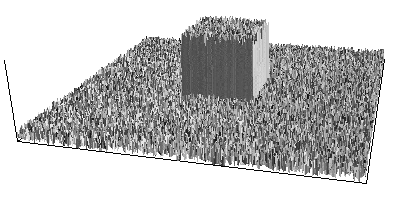

Just to set the scene, Paul Bouke's webpage shows, this picture as the original signal:
Viewed in intensity versus coordinates mode (spatial domain) is like this:

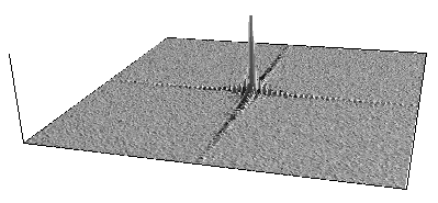

Viewed in frequency domain looks like these:
So that's where I'm coming from. I can't understand the spike picture, how that is frequency domain and what it means when referring back to the original box picture. After some thoughts during dinner and further look up about line spectra for acoustics for better appreciation of signals in simpler terms,

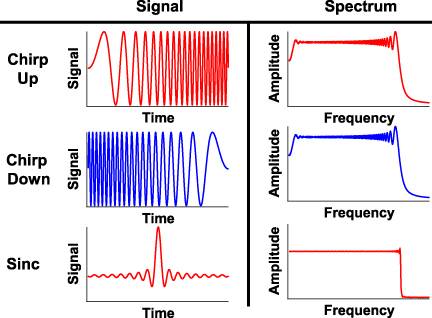

http://www.asel.udel.edu/speech/tutorials/acoustics/freq_domain.html

Paul Bourke's pictures show 2D signals which for my own requirement, I will interpret as corresponding to a digital image (made of pixels and intensities; because I'm self studying digital image processing). In any case it's easier to look at it in one plane first.
The picture in the top upper right (of his webpage) is a spatial representation of the solid white square to its left.
Z axis is intensity of pixel, x and y axes correspond to (x,y) coordinates of each pixel.
In otherwords it's showing intensity of individual pixels with respect to their coordinates.
How does that top upper right picture of his webpage (one that looks like a hill with a plateau) become star shaped when viewed in frequency domain?
Since that hill picture is symmetrical in x and y axes, I figured it'll be easier to just look at one plane first, then the other plane will sort itself out.
So I only look at xz plane of the hill for now. So it's like looking the 3D hill picture side on. I have flat, flat, block rises up, then comes down flat, flat again. That's looking at xz plane of spatial domain.
How does that plateau hill in spatial domain, become a spike in frequency domain? This is my question, and I can't get past this stumbling block :(
So looking at side on view of frequency domain (ie. frequency domain's xz plane), I get this 2D graph: ______|_______ (basically side on view of the spike)
Can someone label the x & z axes for the 3D spike picture for me please? (z axis is the vertical height of that spike)
http://www.paulbourke.net/miscellaneous/imagefilter/fft2.gif
Obviously in frequency domain, x-axis is frequency (and so is y axis). But frequency of what? What does "frequency" mean on the original white square box picture?
http://www.paulbourke.net/miscellaneous/imagefilter/original.gif
I mean the spike picture tells me we have very few of low frequency, lots of middle frequency, then again very few of high frequency.
What is it about the white square box picture that follows this pattern of: few of something, lots of something, few of something again? and is not with respect to coordinates.
Lastly, what's the unit for z axis in the spike picture? Amplitude (as in brightness of pixel)? Change of amplitude?... utterly confused.

Hope my question is clear: can someone label the x and z axes of the spike picture for me please? and explain what frequency means when we look at the flat white solid box picture. Assuming the flat white box picture is a photograph made of pixels with different brightnesses and have some noise in the picture.

It looks to me like the z axis is the amplitude of each frequency component. A continuum of possible frequency components is aligned along the flat bottom in the x and y directions. Higher frequencies toward the edge and lowest in the center (with DC at the very center point) As you add comparatively more amplitude of high frequency components the spatial form of the inverse transformed image becomes sharper or more spiky.

We cannot label the frequency domain until you label the spatial domain. Then the label for the z axis in the frequency domain is the same as the label for the z axis in the spatial domain. And the label for the x-axis in the frequency doman is the inverse (1/x) of the label in the spatial domain.

Suppose for the original solid white box picture, X-axis is labelled "X coordinate of pixel" and Y-axis is labelled "X coordinate of pixel". Z axis is "brightness of pixel at coordinate (x,y)".

In frequency domain (of the solid box picture), the X and Y axes become "inverse of X coordinate" and "inverse of Y coordinate"? and Z remains the same ie. intensity??... What does inverse of x part of (x,y) coordinate even mean?
I thought about it like this: suppose the white solid box has intensity A, and the noises have intensities between say a1 to a99
Obviously that solid white box represents an area of pixels all at intensity A (+/- tiny functuations due to noises).
Does that mean on the spike diagram, just look at it from the side, is saying "the intensity for 'per x coordinate of each pixel' is initially close to 0 then the spike which is 'A' units tall, then after that, the intensity for 'per x coordinate of each' pixel comes down to 0 again". What does this even mean?

Spike diagram's top left hand corner would be saying, "at coordinate (0,0), the number of oscillations is nearly 0". Oscillations of what? Of a pixel? How does a pixel even oscillate? How does a pixel at coordinate (0,0) with a fixed intensity oscillate?
Or take the actual spike itself in the spike diagram. Is it saying "at one particular coordinate, we are getting great oscillations, but all around that coordinate, we are getting very little oscillations"? What does this even mean when referring back to the original solid white box picture? Where in the original box image do we see one thing that oscillates hugely and everything else hardly oscillates? At first I thought okay, something obvious about that white box picture is clearly you have lots of pixels giving you nearly equal amplitude (or intensity) of say magnitude 'A' at the white box. But then I look around the white box and I see even more pixels having roughly equal amplitudes (intensities) of close to 0 all around the box. So if I really draw the spike diagram based on how many pixels give me intensities near A or intensities near 0, then the spike really should be talking about all the background noise, not the white box. If you know what I mean.

Going back to my white box picture and spike picture. Whitebox picture is easy: X, Y is just coordinate of pixel. Z is intensity of each pixel. That's easy.
The spike picture I'd like to label the axes like this:
X-axis is a spectrum of brightness intensity. Ie. along the axis we have for example "-1000 units of brightness (ie. very dark)", "-900", -800,.. , -100, 0, +100, +200, ... +1000 (ie. very bright).
Y axis the same.
The unit for X axis (and Y axis) is brightness. For example Haunsfield Unit, or whatever brightness unit but it's a spectrum of different brightnesses.
Z axis is saying "look at this particular brightness being indicated by one mark on the X axis (for example where x-axis reads "50 units of brightness"), how many of the pixels from the original whitebox picture can you count to have this brightness?
Suppose the white solid box is of brightness 50 units, and suppose that white solid box is made of 100 pixels, then the spike would be 100 units tall in the Z direction. The tip of the spike would therefore be (50,50,100).
Am I right so far?
What then does not make sense to me is this: how about noise? We have so much noise surrounding the white solid box. Shouldn't we have a few ultra high spikes that correspond to brightness intensity of those noises? But the picture we have here is one single big spike. What I mean is, sure I get a big spike for the white solid box, but what happened to my one single even taller spike for all this sea of low intensity signals surrounding the box?

So, suppose in the image domain your axes go from pixel 0 to pixel 100 in steps of 1 pixel. Then in the frequency domain the axes would go from -0.5/pixel to 0.5/pixel in steps of .01/pixel. The number refers to the number of cycles per pixel. So, if the wavelength of a given wave image is 5 then the location in the frequency domain wolud be at the 0.2/pixel location.

In the interactive tool I linked you to as you moved the cursor around to different locations in the frequency domain you obtained different wave forms in the image domain. If you take the spike shape and you move around the frequency domain and at each point in your frequency domain you scale the brightness of the wave image by the brightness of the frequency domain location then you will get a large number of wave images with different spatial frequencies and intensities. If you then add all of those wave images together you will get the white box.

Sorry, I couldn't map what you described into something I could interpret.
The x and y axes could be labeled by what M Quack mentioned: ## \omega_x ## and ## \omega_y ##. As you travel along the x-axis from the edge, the frequency varies from the Nyquist (or cut-off) frequency (at the edge) to 0 (at the center) then presumably to -Nyquist frequency at the opposite edge (that depends on the implementation)
The z axis could be labeled ## W_{\omega} ## where ## W ## is the weight or amplitude of the particular frequency at that x-y position.
The amplitude of the weighted sinusoidal waves of the FT then add up to the same intensity values as in the original picture.
"Noise" is generally regarded as broadband noise (white noise, pink noise, etc.,) That means it contains a pretty consistent amount of all frequencies when sampled in a large time or space window as in your example. So in the transform it will look like a very slighty warbly or spiky low level bottom to the image. You filter it by removing a small amount of every frequency and the resulting FFT plot should have a very flat smooth bottom.
