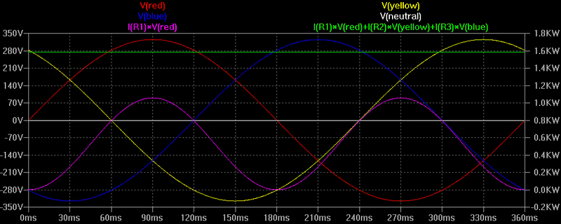

That is correct for 3PH with a balanced resistive load.
The power from each line falls to zero at each zero crossing of the voltage.
The power delivered by each line is an offset sinewave at twice the frequency.
The sum of the power in the three lines has a constant value.

Hi @Baluncore - Thanks for your explanation. Do you know a website where this is shown with some pictures?

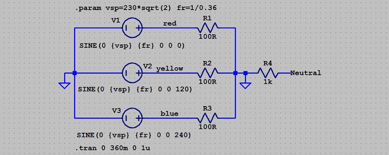

This is for 400 V 3PH = 230 Vrms per phase. Load is 100 ohm per phase
Interpret horizontal ms as phase in degrees.
Magenta is red line power. Green is total power.
  • Love

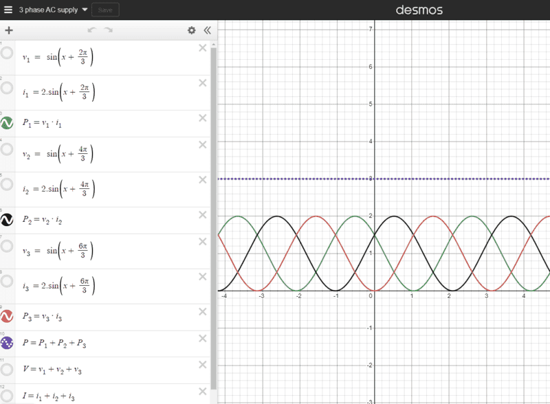

Hi Baluncore,
I also just did a small plot using a website called "desmos" and found the understanding to be correct:
Thank you!

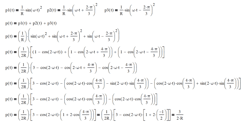

The math looks like this:
