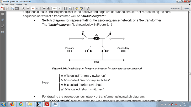

Hi,
So my power system book has a diagram for zero sequence impedance. I cannot find the full form of ZPB. I googled it up but couldn't come across anything.

I'm guessing here, but how about "Zero Potential Branch", i.e the branch that the other branches are referred to for a voltage measurement; the "local ground" for measurements.
Paging @jim hardy. Jim is the local power guy here and can likely come up with a knowledgeable answer.

Baarken said:
From https://madeeasy.in/document/postgate/bookPdf/13PowerSystems.pdf page 10, section 5.3
ZPB = zero power bus (reference bus)

Thanks @Baarken . That makes sense . Balanced Zero sequence returns through neutral so it's intuitive to declare that as reference. "Today i learned.."
