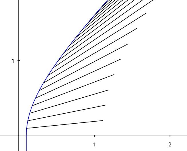

The geometric meaning of the parameter ##u## ("rapidity") in the parametrization of a symmetric unit hyperbola
$$(x,y)=(\cosh u,\sinh u)$$
is not a length but an area as in the following picture
Proof: The green area can be parametrized by
$$\vec{x}(\lambda,u')=\lambda (\cosh u',\sinh u'), \quad \lambda \in [0,1], \quad u' \in [-u,u]$$
Then the area is
$$A=\int_0^1 \mathrm{d} \lambda \int_{-u}^u \mathrm{d} u \epsilon_{jk} \partial_{\lambda} x^{j} \partial_{u'} x^k.$$
The determinant under the integral is
$$\mathrm{det} \begin{pmatrix} \cosh u' & \lambda \sinh u' \\ \sinh u' & \lambda \cosh u' \end{pmatrix} =\lambda'$$
and thus finally
$$A=u.$$
The arc-length of the hyperbola is not that simple. The "arc" from ##(1,0)## to ##P(u)## is
$$L=\int_0^u \mathrm{d} u' \sqrt{\cosh^2 u' + \sinh^2 u'}$$
which is an elliptic function. According to Mathematica you get
$$L=-\mathrm{i} \mathrm{E}(\mathrm{i} u,2).$$
