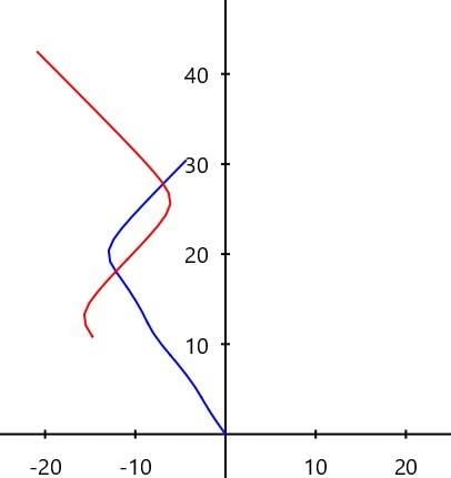

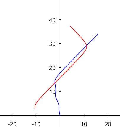

I find it's worth drawing a direct analogy between Minkowski geometry and Euclidean geometry. Invariants are things you can talk about without referencing facts not in evidence.
So the length of a line segment drawn on a piece of paper is an invariant - I can point to the line and (beside a text on Euclidean geometry) that's all you need. Similarly proper time - the interval along a worldline between two specified events - is an invariant.
The angle of a line is not an invariant, because what do I mean by "angle"? Angle between the line and... what? As soon as I say "the angle between this line and that one", or even "the angle between this line and the direction I called ##x##", then that is an invariant. Similarly, an object's rapidity is not an invariant until I specify a worldline that I am using as "at rest". Then everyone can measure the rapidity of the object with respect to my "rest" worldline and will agree my value.
That's kind of what goes wrong in OP's distance example. Defining the relative velocity as 0.8c works fine - it specifies the angle between the worldlines. Asking about time by their clocks means to measure "distance" along their worldlines after the crossing point - again, fine. But talking about "the distance between them" fails because the distance from an event on one worldline to the other worldline is ill-defined. What it probably means is the distance from point on A's worldline to B's worldline along a line perpendicular to A's worldline - but it doesn't say that last bit. As soon as that last bit is added the problem is entirely specified in terms of angles and lines and we're fine.
The complexity in Minkowski geometry is that all worldlines are timelike. That's different from Euclidean geometry where we can draw a real physical line pointing in any direction. This property makes proper time easy to talk about because the worldlines are physical objects and we can talk about "distances" along those lines between events. But there are no spacelike lines. Those we have to specify ourselves, which we usually do either by specifying a straight line between two events or by specifying orthogonality with a timelike line.
