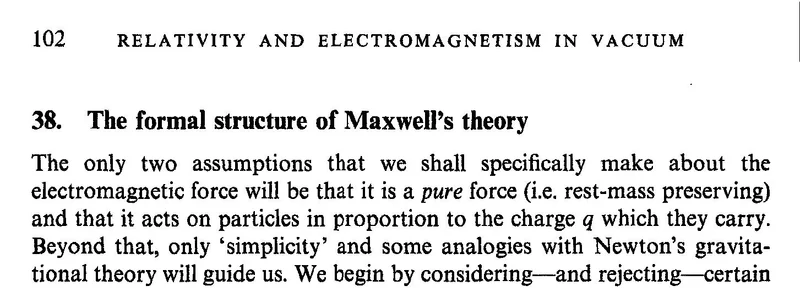

Oh I see, I thought it was Currie-Jordan-Sudarshan's. Wigner's cites them, they write
are all these no interaction theorems different?
