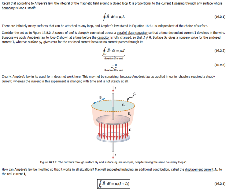

What was that contradiction?

I would guess it had to do with Newtons hypothetical aether, and free space having an intrinsic impedance. That concept was needed before EM wave propagation could be considered.
Wikipedia suggests that what he did was add the dependence of the magnetic field on the time variation of the electric field, which is definitely a necessary component of the derivation of the EM wave equation.
I'm not sure what the contradiction would be from leaving that term out.
Perhaps the "contradiction" is what is explained here in the section "Maxwell’s Correction to the Laws of Electricity and Magnetism":
The Feynman lectures also explain it quite well. Without the term that Maxwell added (called Maxwell's displacement current), the equations are not self consistent.
The equation,
$$\nabla\times{\bf H}=4\pi{\bf j}/c$$,
contradicts the continuity equation because,
$$\nabla\cdot(\nabla\times{\bf H})=(4\pi/c)\nabla\cdot{\bf j}=-4(\pi/c)\partial_t\rho\neq 0$$.
