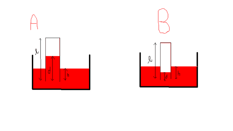

A tube of length L=1 m closed at its upper end is immerged vertically, with its openend, in water by a distance l=27 cm. The atmospherical pressure is the normal one. Find the length of the water column that enters the tube. Consider the process isothermal.
Since the process is isothermal the produc between the pressure of the gas and its volume is constat. I belvie we also need the formula for the hydrostatic pressure.
Here's what bugs me. When we Immerge a tube in the conditions of the problem, what is the correct situation? A or B? What I mean is, does the level of the liquid in the tube stabilize below the level of the liquid in the vase, or above it?
I say that the correct situation is B, because we "push" the liquid with a certain force due tot the air molecules inside the tube, but I'm not sure. I found situation A quite plasauble.
Please, help me! :(

First, is the tube closed on the top, as it appears to be in the pictures? Then the air in the tube must be compressed by some pressure greater than that acting on the top of the liquid. And that is only possible if the air presses down into the liquid.

The liquid at the surface does have a certain pressure. This is the pressure of the atmosphere that surrounds it. Will that cause the liquid to shoot up if you insert a tube, closed at the top, with air at the atmospheric pressure?
If any liquid enters the tube, the pressure within the air in the tube will be higher than atmospheric. That would mean that figure B is correct. Use the ideal gas law to express the new pressure within the gas in terms of the tube length L, and the distance d. How does the pressure at the bottom of the tube have to be related to the pressure in the remainder of the reservoir at the depth h?

Something must force the liquid into the tube for situation A to happen. What could that be?
A difference of pressure between the air in the tube and the liquid, at the contact point between them?

Consider a very small volume of liquid of a negligible mass just at its surface. We know it does not move with time, so its velocity and acceleration are zero. By Newton's second law, the sum of all the forces must then also be zero. But we have a downward force due to the atmospheric pressure. Something then must cancel this force out. What is it?

Well, let's consider the lower end of the tube. At that level, the pressure must be the same everywhere. So, we have (consider p_0 the atmospherical pressure):
[itex]p_0+\rho g h=p_A+ \rho g d => p_A=p_0-\rho g (h-d)[/itex].

Then, let's take the A situation. Consider a intial situation, when the tube begins to make contact with the surface of the water, and the A situation as the final one. In the initial situation, a volume [itex]Sl[/itex] of air at atmospherical pressure, [itex]p_A[/itex], will be enclosed in the tube. So we have:
[itex]p_1=p_a<br /> V_1=Sl[/itex]
For the final state:
[itex] p_2=\rho g(h-d)+ p_a<br /> <br /> V_2=(L-d)S[/itex]
As this is an isothermical transformation we have that: [itex]p_1V_1=p_2V_2=><br /> <br /> 0= \rho ghd^2-d(\rho gL+\rho gh+ p_a)+\rho ghL[/itex] which is a quadratic equation.

No, that should be ## p_A=p_0 + \rho g (h-d) ##. And because ## d > h ##, you have ## p_A < p_0 ##. Now, how could that happen in a tube with its top closed?

In both situations A and B, by the ideal gas law, the pressure of the air within the tube is [itex]p_a\frac{L}{L-d}[/itex]. The pressure at the bottom of the tube is then [itex]p_a\frac{L}{L-d}+ρgd[/itex]. This must match the pressure within the reservoir at the depth of the bottom of the tube [itex]p_a+ρgh[/itex]. Equating these pressures gives (at static equilibrium):
[tex]p_a\frac{L}{L-d}+ρgd=p_a+ρgh[/tex]
All that needs to be done us to solve this equation for d, using the quadratic formula.

So, have you understood which of A and B is possible and why?

I get it, I get it, I get it! O my God, I can't believe I finally got it! Well, if the temperature remains the same, in situation A, the final pressure drops. If the final pressure drops, that means that the volume of the air increases, by the law of the isothermical transformation. But this is a contradction, since the air molecuels can't escape the tube! So, the situation A is impossible! You guys, are the best!
Also it is clear, that the volume occupied by the gas molecules decreases since a part of the tube will be filled with liquid.

P.S. Well done on your final conclusion!
