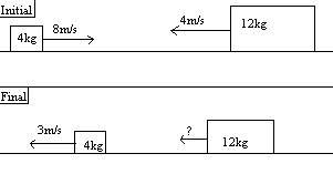

A small block m=4kg and a large block m=12kg have a head on collision on a frictionless table. Before the collision, the small block is traveling 8m/s to the right and the large block is traveling 4m/s to the left.
A. If the small block bounces back at 3m/s to the left, find the final velocity of the large block.
B. Suppose instead the two blocks stick together after they collide. How many Joules of energy would be lost?

I will define to the right to be the positive x direction.
First I will calculate initial momentum for both blocks.
[tex]p_{i a}=mv[/tex]
[tex]p_{i a}=(4kg)(8m/s)[/tex]
[tex]p_{i a}=32kg m/s[/tex]
[tex]p_{i b}=mv[/tex]
[tex]p_{i b}=(12kg)(-4m/s)[/tex]
[tex]p_{i b}=-48kg m/s[/tex]
[tex]p_{i}=-16kg m/s[/tex]
Now final momentum:
[tex]p_{f a}=mv[/tex]
[tex]p_{f a}=(4kg)(-3m/s)[/tex]
[tex]p_{f a}=-12kg m/s[/tex]
[tex]p_{f b}=mv[/tex]
[tex]p_{f b}=(12kg)v[/tex]
[tex]p_{f b}=12v[/tex]
[tex]p_{f}=-12kg m/s + 12v[/tex]
If momentum is conserved, then
[tex]p_{i}=p_{f}[/tex]
[tex]-16kg m/s=-12kg m/s + 12v[/tex]
[tex]v=\frac{-1}{3}[/tex]
So far you are correct. Is there a question you wish to ask?
Oh, great. I had a feeling I was on the wrong track.
For part B, I need to find the energy. It is all Kinetic.[tex]KE_{i}=\frac{1}{2}mv_{a}^{2}+\frac{1}{2}mv_{b}^{2}[/tex]
[tex]KE_{i}=\frac{1}{2}(4)(8)^{2}+\frac{1}{2}(12)(4)^{2}[/tex]
[tex]KE_{i}=128+96[/tex]
[tex]KE_{i}=224J[/tex]
Now the final kinetic energy is where I am getting confused.
[tex]KE_{f}=\frac{1}{2}mv_{a}^{2}+\frac{1}{2}mv_{b}^{2}[/tex]
How can I find the velocity of the two blocks?
Actually, for part B I did it another way:
[tex]p_{i}=32+-48[/tex]
[tex]p_{i}=-16[/tex]
[tex]p_{f}=16v[/tex]
[tex]-16=16v[/tex]
[tex]v=-1m/s, or 1 m/s to the left[/tex]
[tex]KE_{i}=\frac{1}{2}mv^{2}+\frac{1}{2}mv^{2}[/tex]
[tex]KE_{f}=\frac{1}{2}mv^{2}[/tex]
[tex]KE_{f}=\frac{1}{2}(16)(1)^{2}[/tex]
[tex]KE_{f}=8J[/tex]
[tex]KE_{i}-KE_{f}=E_{lost}[/tex]
[tex]224-8=E_{lost}[/tex]
[tex]E_{lost}=216J[/tex]
That looks about right.
