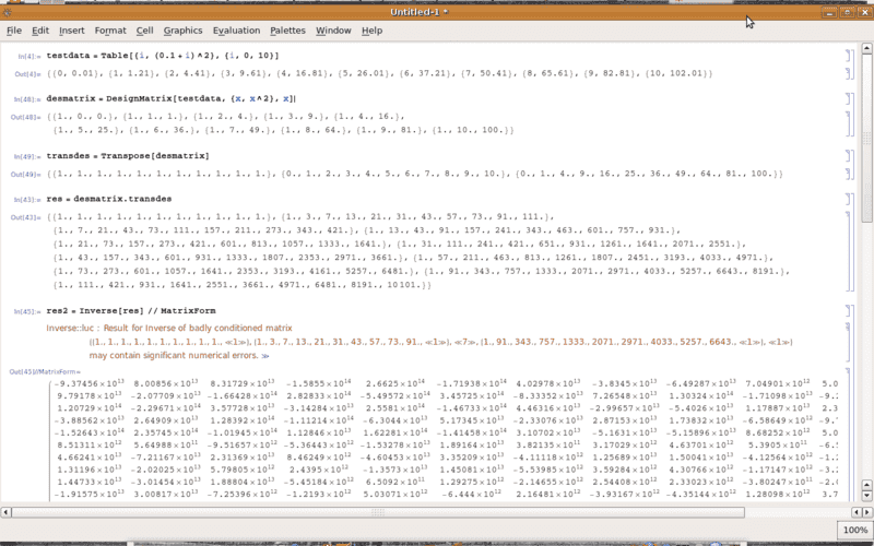

I was given a set of data from a Ion engine experiment. I fitted the data with an 8th order polynomial that seems pretty reasonable. What I want is the uncertainty in the coefficients.
One way I read was through the design matrix.
[tex]C_{ij}=(A^T A)^{-1}[/tex]
The square root of the diagonals give the uncertainties. But my matrix in not invertible since its not square.
What am I missing?

The matrix A may not be square, but
[tex](A^T A)[/tex]
is square, so it's invertible.

Thank you. Yes it turns out square but the inverse gives me problems.
Maybe I am using the command wrong.
Here are the results of a test.
I threw in .1 just for error sake. My model is a+bx+cx^2. The uncertainties are suppose to be given by the square root of the diagonals of
[tex](A^T A)^{-1}[/tex] A being the design matrix.
Never mind I got it.
I was able to find the covariance matrix and the associated uncertainties. I feel stupid.
