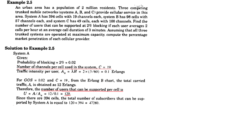

If a channel is 5Khz for a full duplex system in cellular systems does that mean person A and person B are using the whole 5Khz to communicate?
Or can the channel accommodate a lot of people?
The 5kHz slot would be for one connection. Each person-to-person connection would need its own slot.
There are modulation schemes where this is not totally true -- schemes where the comm "channels" are spread over a wider bandwidth, and interleaved in various ways.
Here is a reasonable introduction to modulation:
http://en.wikipedia.org/wiki/Modulation
thanks for reply, but I am having tough time understanding this
I read that
each call requires a channel. But in the question below I have 19 channels but 120 users. Isn't that ineffecient as there will be a lot of calls being blocked.
Would not the probability of a call being blocked be too high??
