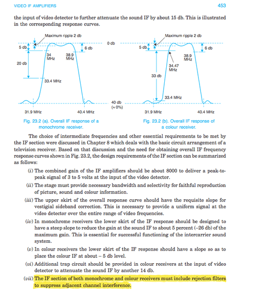

Hi guys
The IF section of both monochrome and colour receivers must include rejection filters to suppress adjacent channel interference...
Why exactly so, since the work of rf tuner in television receiver is to select a particular channel and as the required channel is selected it then passes to the mixer where IF frequencies are generated, then why the author says that IF section should consist of rejection filters to suppress ACI. I mean that already this work is accomplished by the tv tuner where only required channel is selected from the band of channels. So does the provision of rejection filters in the IF section really make sense.
thanks

By your logic of the work already being done in the tuner we should not even need the bandpass section of the IF stage. Your assumptions are wrong.
The modern TV tuner for NTSC, which I assume you are referring to simply shifts a band of frequencies to the intermediate frequency. This frequency is 45.75 MHz. While tuners do have a tracking filter on the input side to aid in suppressing adjacent channel signals the main filtering is done in the IF stage. I assume PAL is similar if not identical.

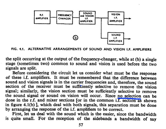

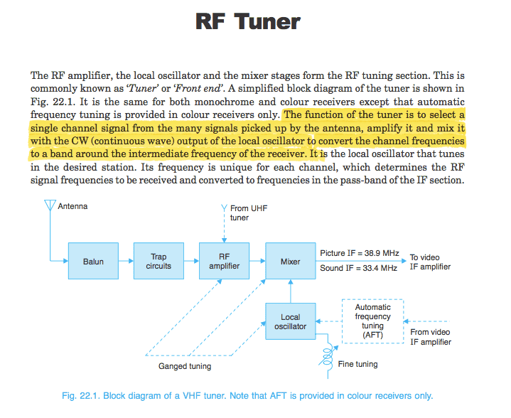

I said...
text which supported this is below..

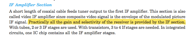

you said..
text which supported this is..
Isn't both explanations seems contradictory to each other...

I don't believe I can explain any better than I already did.
The one statement in the above quote agrees with your textbook. We cannot rely on the tuner from blocking 100% of the adjacent channel signals.

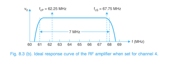

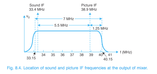

tech99 said:
It is not possible to obtain sufficient selectivity at 800 MHz using ordinary tuned circuits, and so the filtration is mainly achieved at IF. However, the tuner must provide all the image rejection.
as the ideal responses are as follows
RF amplifier of tuner ideal response..
Mixer ideal response
Can you provide me NON IDEAL output response of all rf amplifier , mixer and IF section

Your picture of the mixer ideal response would be a bit unrealistic. That response would be achieved within the IF stage, not within the mixer. All the mixer filter needs to do is to isolate the wanted mixing product from any others. I would suggest that the labels on your two diagrams are not referring to the appropriate stages in the receiver. The overall response up to the mixer output would be more like the first diagram and the overall response of the receiver would be like the second. The difference between the monochrome and colour responses will probably be to do with the requirement for compatibility and to ensure that not too much of the lower sideband of the colour subcarrier. Remember, it is a Vestigial Sideband (VSB) system so the slope across the carrier frequency needs to be symmetrical to control VSB distortion.
How much are you familiar with UHF TV systems? Are we discussing all this at the appropriate level?

I consider myself to a beginner in television engineering...
The following reference which I have taken is from..
television servicing vol 1...by patchett
The text here clearly states what probably sophiecentaur is talking about ...
The text clearly states that the tuner section of the receiver never provides any selectivity as the selectivity here means to separate sound and picture rf carrier amongst each other for this purpose IF section is designed all about.
What I mistakenly thought earlier was that the tuner does the selectivity by picking out a particular channel frequency from the bunch of channels...however this is a tuning action and should not be confused with selectivity.
But its true that the channel selection is provided by the tuner section where rejection of adjacent channel interference can dealt and my quote...

UHF AM Colour TV systems are a real labyrinth with many levels of complexity. It's really not the best thing to start with, learning about TV. As I read this thread, stuff keeps bubbling to the surface of my memory from decades ago. The RF and demodulation bits are only the start. Books and books have been written about the features of PAL and NTSC systems which were only done the way they were in order that the colour signal would be compatible with monochrome sets. How deep do you want to go with this? It is all water under the bridge.
The comment in that extract about there being "no selection" reads as total nonsense if taken out of context. A mixer will produce many products at many frequencies. The output of the mixer is where frequencies in the wanted channel are selected. (the IF band) At this stage, both vision and sound signals are there. Demodulation of the sound carrier involves the inter-carrier beat to produce and isolate the 5.5MHZ sound carrier. The frequency stability of old mixer systems couldn't be relied on to keep the sound carrier in the right spot for FM demodulation.
I seriously suggest that you should read more around this subject because 'servicing' manuals are not always good for 'education' in a topic. Some of the statements you are making about what you have understood are muddled. More reading could clear this problem up.

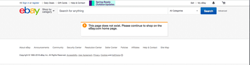

I did this multiple times but what I have found is this
and this
I might expect you that you may have remembered the author

The page that my link gave me was this one which is not an (ordinary) eBay link. Very strange. Can you see what I saw now?
Which part of the World are you in? That may be making a difference.
