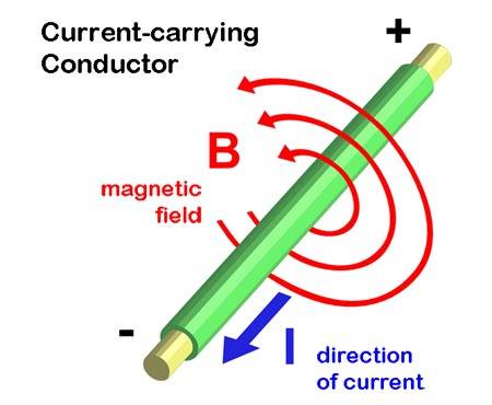

But--
When i tried to work the positively charged cat video in my alleged brain, i got a "runtime error".
Here it is.
We have negative charge in motion due to the electron borne current in the wire, so a magnetic field surrounds it
When wire is stationary and +cat moves along it, there's relative motion between him and the field surrounding the wire's moving negative charge.
So +cat experiences F=QVcross B.
But when in the video, Mr +cat moves along in step with the negative electron borne charges in that wire, he no longer has relative motion wrt that negative charge.
Narrator asserted that in +cat's frame of reference, the magnetic field disappears because the relative motion disappeared.
I counter assert that +cat now has motion relative to the positive charges inside the wire which are moving wrt +cat from his nose toward his tail as he progresses along the wire.(or as it progresses under him).
Mr +cat sees j dot ds for positive and negative charges inside the wire that are not equal because of the tiny electron drift velocity, which narrator emphatically quantified as tiny relative to c.
By right and left hand rules, the magnetic field experienced by +cat from +charge (inside the wire) moving in direction from from his head to his tail
is the same as that experienced from -charge(inside the wire) moving opposite way in other reference frame.
The two reference frames yield the same magnetic field.
SO - i was unable to accept that cat video.
For me it's QV cross B in both cases. What'd i miss ??

  • #35
the_emi_guy said:
the cat would see a magnetic field from the moving (+) charges (not mentioned by narrator) but there is no force because there is no charge moving relative to this field. Remember, from the cat's frame of reference his own charge is not in motion.
Thanks !
i'm toggling that picture in my mind.
+cat sees the wire moving backward with respect to himself, because he and his reference frame are moving forward with the electron drift which is admittedly small but finite.
So - does +cat see those "Maxwell halos" of mmf (and flux) encircling the wire as stationary, or moving backward with the wire?
I know why I'm hung up - read Flatland as a kid.
Viewed from above those circles would appear straight lines , as do the men in Flatland
and the initial analogy of riding in a train planted the visual image of railroad tracks, where the ties are straight lines as are circles viewed from their own plane...
Viewed from a locomotive windshield the rail looks stationary(only because it's smooth) but the ties shoot by backward
and that's the visual image i affixed to those flux halos surrounding a wire..
So my question becomes
do those red B circles move along in direction of I with the moving +charges they encircle ? If so, they're moving backward in +cat's frame.
It would seem at first that they must - a single charge in motion would surely find itself surrounded by an accompanying "Maxwell Halo" .
Edit - added :
If that's so, then +cat sees relative motion between himself and those B circles ??
I'm sorry to appear stubborn - its just i need to reconcile this little point in order to progress. No mischief intended.
  • #36
Jim,
In this case the B circles don't move. Constant current in a long straight wire creates a static magnetic field, analogous to the static E field between capacitor plates.
Motion of a charge relative to this static B field creates force.
The case of a single electron in motion is a different story. Here you will have a time & space varying set of E and H fields as the charge comes and goes.
It is the unique symmetry of the infinitely long straight wire with constant current that allows the "cat video" to nicely transform purely magnetic force in one frame of reference to purely electric force in another.
In the general case we will have time and position varying E and H fields in both frames of reference, and all of the math (Susskind, Feynman et al) shows us how to transform these fields between frames of reference.
