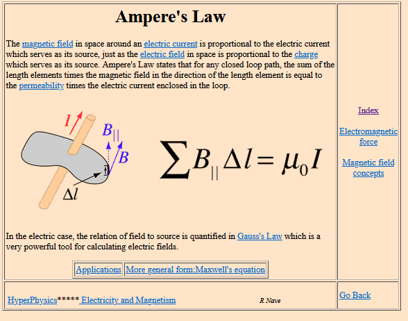

Are you familiar with Ampere's Law? If the same current is enclosed by the same loop (at your specified radius), then the B-field is the same:
Diagram of Ampere's Law showing a closed loop path around a current-carrying wire, with the line integral of B parallel times dl equals mu0 I, and labels I, B, B parallel and dl.
http://hyperphysics.phy-astr.gsu.edu/hbase/magnetic/amplaw.html
Can you say more about what you want to shield? There can be other options to accomplish what you need...

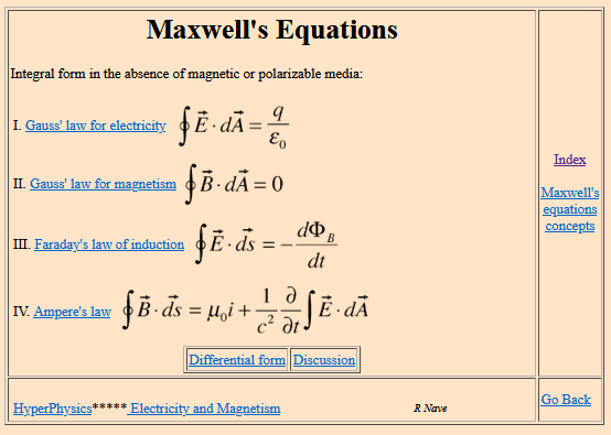

If the current density decreases, doesn't H also decrease?
  • Ampère-Maxwell law in differential form: curl of H equals J plus the partial derivative of D with respect to t, with vector arrows over H, J and D.
Of course. The current density enclosed by your radius measurement loop. How does that density change once you are outside of the raduis of the wire?

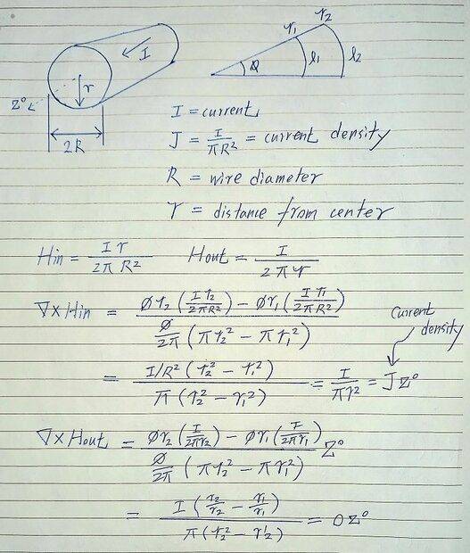

It is easy to show that the curl of magnetic field everywhere inside the wire is equal to the current density, and the curl of magnetic field everywhere outside the wire is zero, no calculus required.
Handwritten notes on lined paper: a sketch of a cylindrical wire carrying current I with radius R, a conical or tapered wedge diagram with radii r1 and r2, definitions I = current, J = I/(pi R^2) = current density, and R = wire radius, then Hin = Ir/(2 pi R^2) and Hout = I/(2 pi r), followed by curl derivations for each.
Correction : R = Wire Radius
