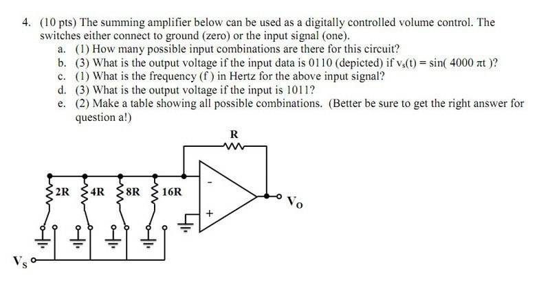

Please refer to attached image!
Absolutely no idea how to start this problem!
A) I would think that there are 4 input combinations for this circuit.
B) 0110 = 6v?
C) No clue
D) 1011 = 11v?
E) No clue

Part C is simple, the input is given in sin(2*pi*f*t). Just plug n chug to find f.

But the problem vs(t) = sin(4000pit)
So ω = 4000?
2pi*f*t = 4000*pi*t
so f = 2000hz?

How about Part D?
It's a summing amplifier. When one input is grounded, contribution from that branch is zero.
For the other inputs, since 3 resistors are connected to same voltage, they are in parallel.
This should help you understand summing amplifiers - http://www.ecircuitcenter.com/circuits/opsum/opsum.htm
