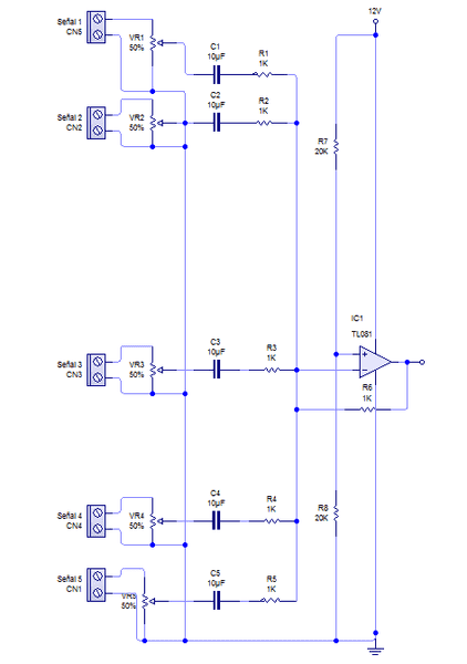

Hi everyone, I'm going to comment about something that happened to me today using Summing OpAmps.
First, I simulated the attached circuit in a Project Board. It's supposed to be a Single Supply summing op amp with unity gain. The thing is it never worked. The signals didnt even appear in the output. I measured with an oscilloscope the output of the op amp and there seems to be a permanent noise.

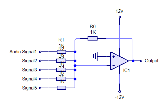

Second, I simulated the summing amplifier but with dual supplies. Because of that, i also removed the capacitors that were supposed to cleanse the DC signal going thru the input of the op amp. It worked wonderfully.
Comments about the issue please...
The IC was a TL081. Also, I simulated it with both Audio signals and signals from a Function Generator.
  • Schematic of a single-supply summing amplifier with five input channels, each with a 50% potentiometer, coupling capacitor and 1K resistor, feeding IC1 TL081 with 12V supply and 20K feedback resistor.
  • Schematic of a summing amplifier with five 1K input resistors R1 to R5 feeding the inverting input of op amp IC1, feedback resistor R6 1K, and a grounded non-inverting input, supplied from +12V and -12V.
When you have a single power source, both inputs have to be connected to a reference of about half of the supply voltage.
In the first example, your non-inverting input is connected like this, but the inverting input is connected via an electrolytic capacitor and resistors to ground.
Electrolytic capacitors are leaky and can be considered to have some shunt resistance across them. So, your inverting input was connected via a series of resistors to ground.
So, the result you got is quite normal. The output would have gone high and approached the supply voltage.

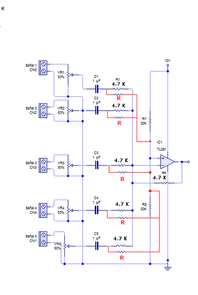

Schematic of a five-input summing amplifier with inputs Sefal 1 to Sefal 5 (CN5, CN2, CN3, CN4, CN1), each with a 50% trimmer VR1 to VR5, a 1 µF coupling capacitor and a 4.7 K input resistor, feeding an IC1 TL081 op-amp with a 20K feedback resistor and a 12V supply.
I modified your diagram to show how I think it would work, but it uses so many components that it is better to use two power supplies. Maybe with just two channels it would be possible.
The resistors marked R would be about 47 K. This is 10 times the input resistor. Notice how they return to the half-voltage point.
I changed the capacitors to 1 uF so that you could use non-electrolytics. To do this, the input impedance of the amplifier has to be raised, so the feedback resistors are 4.7 K. This gives a low frequency rolloff at about 150 Hz. These capacitors get fairly expensive above 1 uF.
Just using these capacitors may be enough to make it work without adding the 47 K resistors. There is a similar circuit here:
http://www.casperelectronics.com/images/simpleCircuits/mixer_sc.gif
which just uses 0.1 uF capcitors and 100 K feedback resistors.
